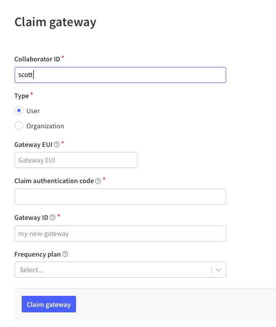

I followed the docs which said I must register this indoor gateway by the claiming process. Upon starting the claim, I am presented with this form:
Screen Shot 2022-03-08 at 8.48.16 AM
Nothing there allows me to choose community vs. private.
Yes, when creating my account I did choose the Cloud option with the Discovery option. I would not think these choice would have any bearing on the claiming of the gateway, but if they did that would be reflected on the options on claim forms.
