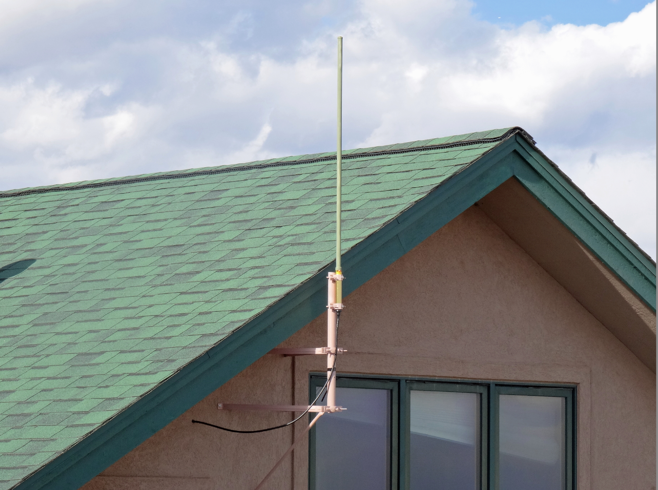

I suppose I can’t rule out that it transmitted into an open circuit, although as an RF engineer I am usually very careful about that. Yes, the module does seem to be very deaf, I think I have established that. I am in a high lightning area and although there hasn’t been a strike close by in the last year or two, I suppose there could still have been enough of a transient induced on my antenna to damage the unit. I have a big external Laird antenna about 10m up in the air. I will re-check its swr before I connect anything new up to it.

As for the coax, no, the gateway is right up in my walk-in closet! The coax goes pretty much straight through the dry wall to the gateway. So there is about 2m of LMR400 coax. (plus a gaggle of adapters to get from the N on the coax to the RP-SMA on the gateway!).
