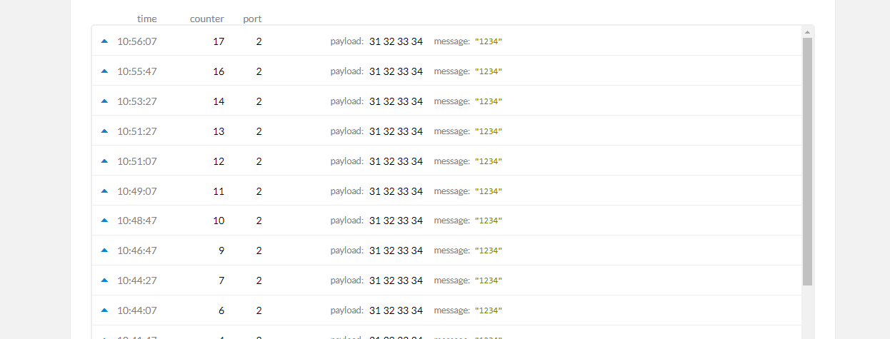

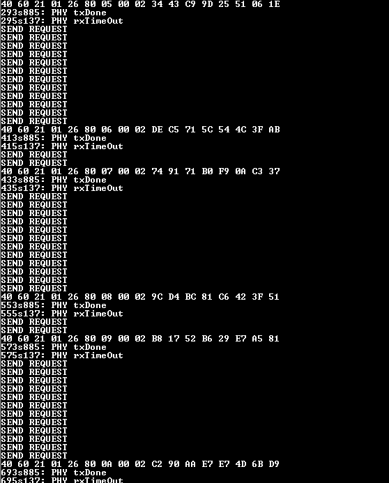

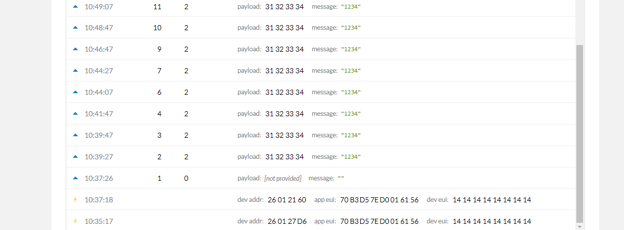

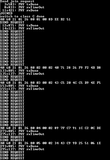

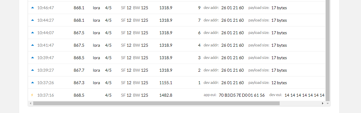

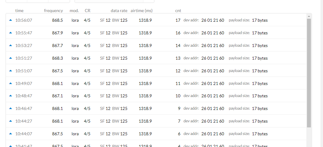

Sometimes it takings long time to join and when if joined I won’t get the data on my TTN application even not in gateway log as per fixed time interval.
I’m continuously pushing the data on 10 seconds but only gets delivered to application.
I’t seems like it follows the fix time to push the next data around 2 minutes.
Does anyone have the idea about this or any suggestion to guide me in proper way.
Thanks in advance!
