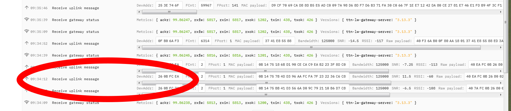

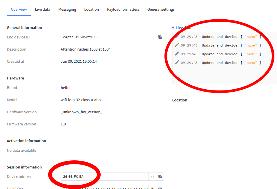

Here are screen of gateway and device in ttn where hour to see gateway receive but not application
Gateway
and device (application)
Gateway
i just see on my log server and nothing. Webhooks don’t send datas to my server and application in ttn v3 don’t see my device but gateway see it
