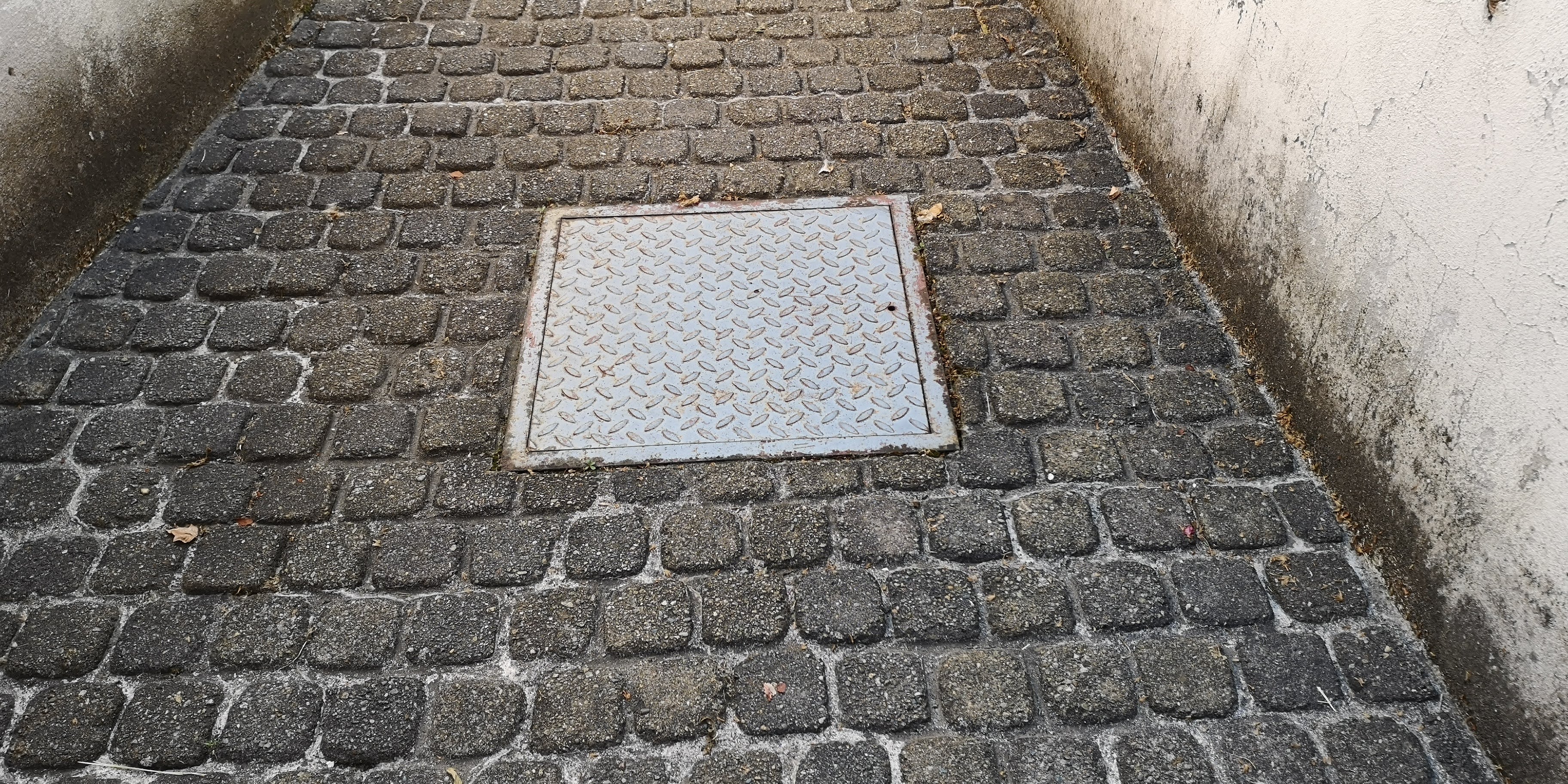

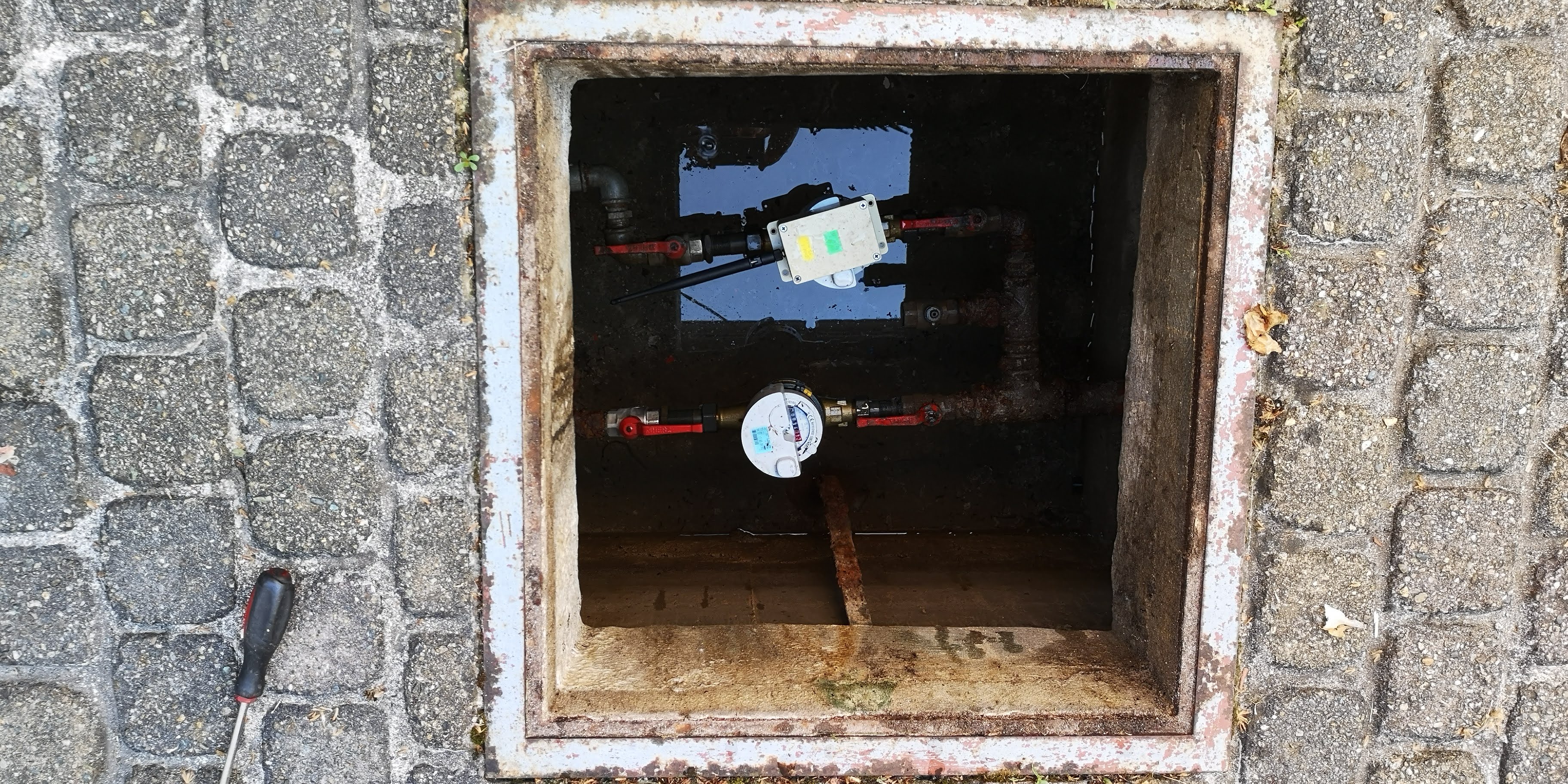

I am pretty sure if you use proper antenna (Farnell 230-5899, just for an example), your LoRa waves will travel over long distance. Just that you can feel what LoRa can do. You can see on a picture my node in underground shaft, covered with metal cover. Still got -110 dB on the Rpi+IMST gateway, 12 meters away, mounted on the roof of my house.
Assuming that your gateway has 0 dBd gain and no cable loss, while your node has a 0 dBd gain antenna (which is not true) and no cable loss (which is likely), your Free Space Loss (FSL) at 868 MHz is about 53 dB. Lets calculate your actual path loss in your case: +14 - 110 = 124 dB. Now we can calculate the attenuation that your hole-in-the-ground-with-metal-lid implies: 124 - 53 = 71 dB ! In no way you can compensate this loss with a better antenna. When you increase the gain of one of these antennas with 6 dB you will double the range of your gateway from 12 to 24 meters.
You better get out of that hole.
Ps. I love this use-case. Thank you for the example.
I see antenna mounted horizontal, vs I assume gw ant vertical Reflections in pit will help but also try 45 deg or vertical mount as may see 3-10db signal improvement depending on ant patterns and relative positions. If gw directly above vertical ant may even get worse but suspect that’s not the case here…
