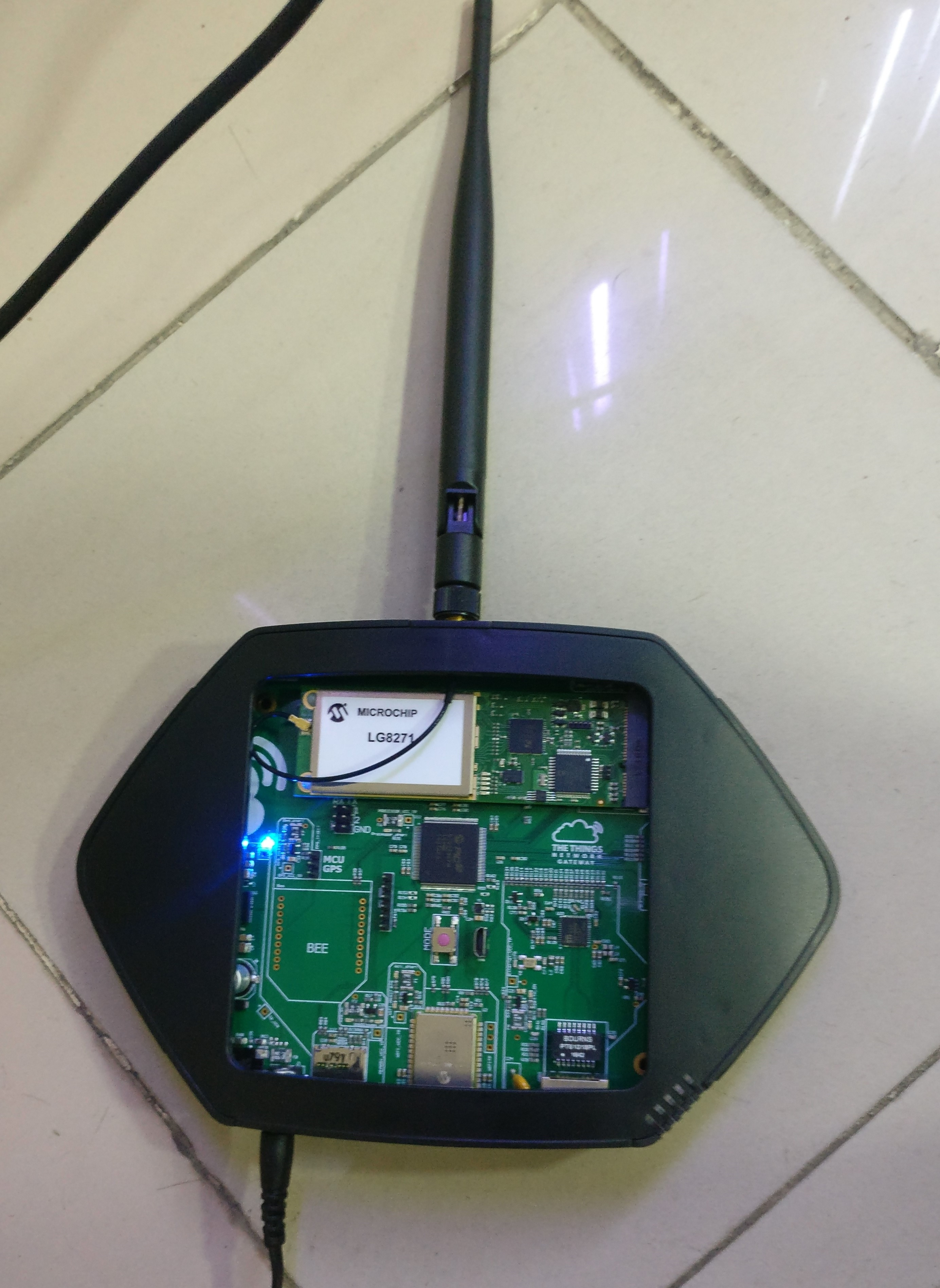

Our TTN gateway worked for 15 days and now since three days it suddenly stopped working.
[MOD EDIT] @textra wrote below: “we did reset by holding the button while powering on the gateway”
:warning: Resetting the gateway by holding the button while powering on the gateway will erase the serial flash including all settings and the firmware. Don’t do that unless you know what you’re doing.
Please suggest us how to troubleshoot. For reference please find the image
we looked at the image but we didn’t find the problem

See the activation lights are not blinking and we can’t find the gateway in ttn.fyi/activate.

We tried with the Multitech power adapter, but it remains same, nothing changed.
Only the Blue dot light on the board is on and remaining LED’s for Indications are off.

so you don’t have a bootloader on board , you need to flash the gateway firmware.
