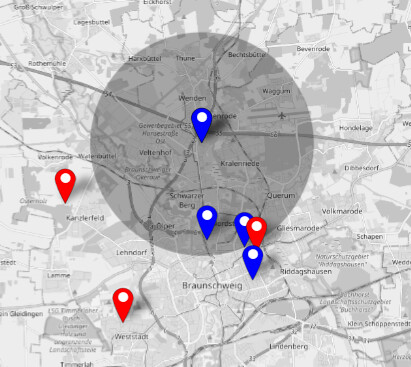

1st instance check TTN Map: https://www.thethingsnetwork.org/map
If it has been seen live recently it will show on there
2nd Look at your local community (ok, ok I know the community pages have recently stopped showing in area GW’s - have flagged to issue via Slack, but no response yet), in general if seen recently and IIRC active in last 3 days shows in Blue, if not seen active for >3 days it will show red, and again IIRC if not seen for ~ 1month (might be 28/30 days) it will age off and no longer show.
3rd if not part of a community area then look at e.g. TTNMapper, similar status/aging rules apply though not sure exact times for TTNMapper.

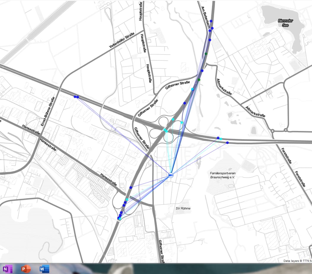

@BS-38108-01 BTW as I noted above I suspect you will struggle to get signal from where you are to that GW, given your low ant height and GW low level wrt local ground. I just pulled a view of captured data from TTNMapper for that GW from start of April through 1st 2 weeks July and as you can see below whilst some coverage on local Autobahns range looks limited to approx 500m-1km around the GW (probably placed to specifically monitor the Kreiz) with longest signal approx 1.7km to the north…as noted you need to either get your own test GW (a TTIG will do) or get in your car

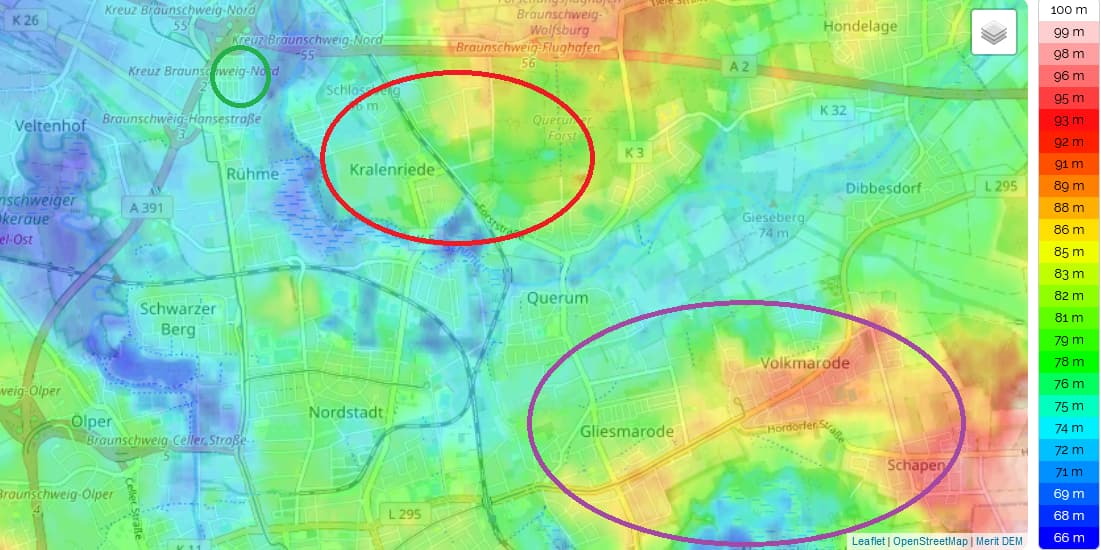

If you refer to my text in earlier post wrt coverage likelyhood from your location (yesterday) and look at below image - Green circle approx GW location - note low ground…am concerned higher ground around Kralenriede may mask (red area) especially if the wrong side of the high ground - S/SE/E - of BerlinerStr on the hill highlighted purple… The Kralenriede higher ground also likely accounts for the concentration of measured points on the TTNMapper extract above (nothing in an arc approx south to east of GW location)
