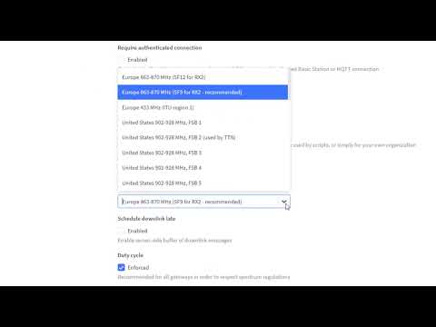

A video tutorial from Erik Lins (Laird), might be helpful for other users.
