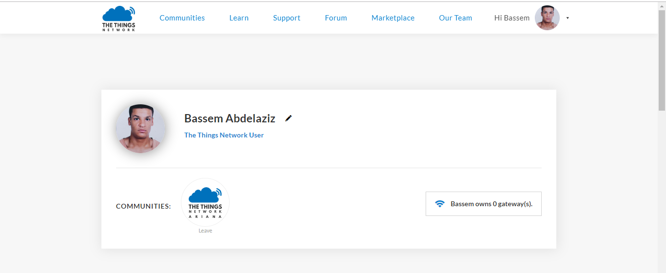

I Have an other Problem why in my profile i see 0 gateways ? But in console i have 1 ?

do you have a node yourself ? … looks like there are not many around you to test your gateway
Why in ("" Last seen “”) it counts from 2 up to 32 seconds after it comes back to count from 2 is it normal ?
its updated every 30 seconds
