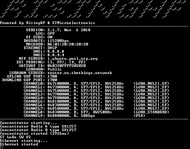

No the description is just a ‘useful’ human readable description. The Gateway ID for the device as shown in you original picture (below) and as I refe’d in original reply and the Gateway ID as registered in the TTN console (per my update in my last post above) need to match…that is how the TTN NS/Console identifies who sent the message and forwards to any apps and updates the consiole…if they dont match that would explain why it shows as not seeen - no matching ID based messages have ever been received even though TTN may have actually received them…it woud have dropped them as erroneous not knowing how to treat them
Hi Jeff,
I had already removed the first gateway so I created a new MAC address which in turn gave me a new GW ID: Same result…

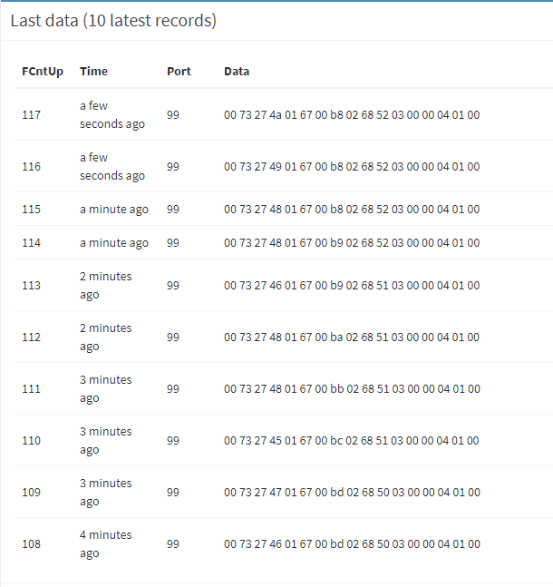

I just loaded the Loriot firmware and followed the instructions and I have the I-NUCLEO-LRWAN1 sending live data to the Cayenne hosting platform. At this point I am thinking it is a ThingsNetwork issue…

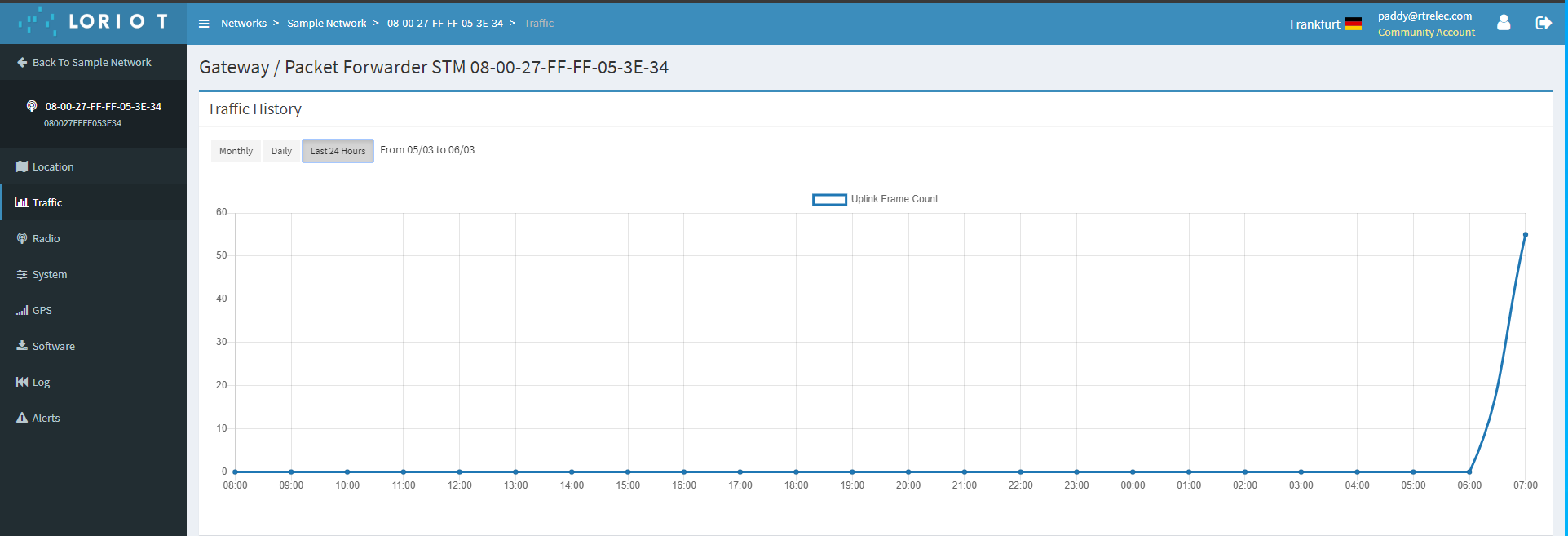

I have had the gateway and 2 nodes setup through Loriot since last week and apart from one of the devices going into sleep mode from time to time (I haven’t even looked at how to program them yet) communication looks good.
