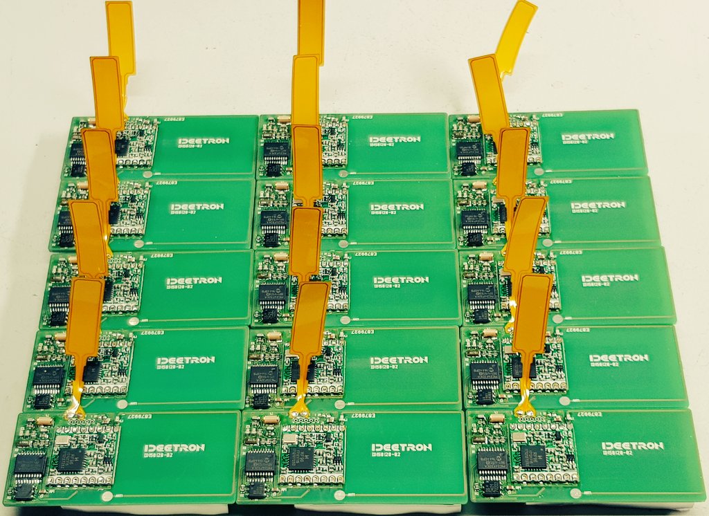

source : https://twitter.com/ideetron

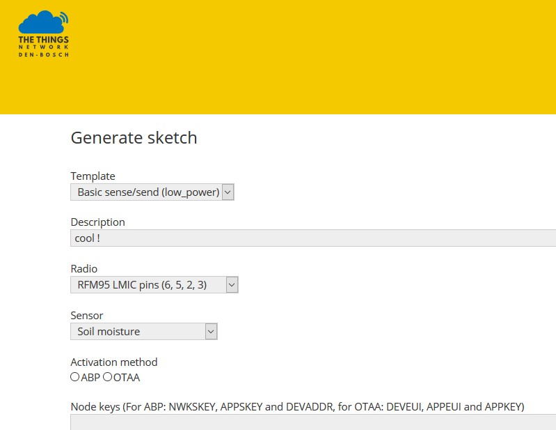

TTN 's-Hertogenbosch - NL sketch generator
