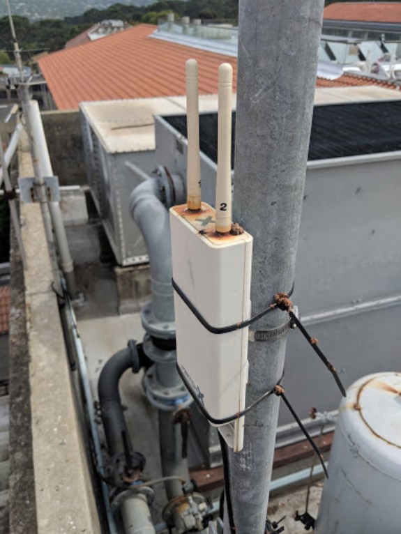

Match-X after one year in Capetown
Interesting - don’t know whose this is but is that rust at base of the antennas? Also likely better performance & coverage if they had mounted at least >1/2 to >full wavelength clear of the (metal?) pole?!
its from a post on Slack from YaguraStation yesterday
I have had the same with an outdoor node, bad quality antenna sma connector, N connectors are better for outdoor use
Agree, and where I have to use SMA instead of N-type I coat with generous helping of vaseline/petroleum jelly (old car connector battery trick!) or some waterproof translucent silicone sealant
