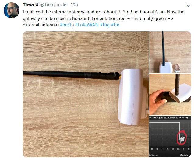

I received yesterday some 868 MHz TTIG (gateways) from RS . The right (EU) power connector was included in the box. The Things Network registration was very succesfull (5 min) on the first attempt.
The location’s are now Netherlands (Uithoorn), but they will be placed somewhere in Friesland (north off the Netherlands) for a monitoring project.
These gateways will be converted to a external antenna as I did above.

I have this gateway since 2 month and screw an external sma connector on it. I think it’s quite good but I prefer to mount it outdoors to shorten the antenna cable length and mount it at a high point.
Is the electronics inside basically able to withstand temperatures down to -20C up to 50C? A water protected case should not be a problem including condensate water outlet.
In principle, SX1308 has a reduced temperature range (0-70), so not suitable for outdoors.
Specs wise probably not, but depending on the external case used, when using TTIG’s built-in power supply it will at least be a bit warmer than the surrounding air temperature.
I was thinking the same but this should be a good isolated (Polystyrene foam) case that does not overheat in summer.
The receiver is quite good, maybe it’s worth. On the other hand 3-5m antenna cable is much easier to realise…
I was going to suggest the same, but thinking at the other side of the range, it might become too hot under the sun… and not sure that with continuous exposure some foam will suffice . With a more programmable gateway, I would add a temperature sensor in the enclosure to monitor the situation.
Yes. Unfortunately the TTIG is not that programmable.
Its ESP8266 MCU is limited on resources and available IO ports. An ESP32 would have been more flexible and more powerful.
