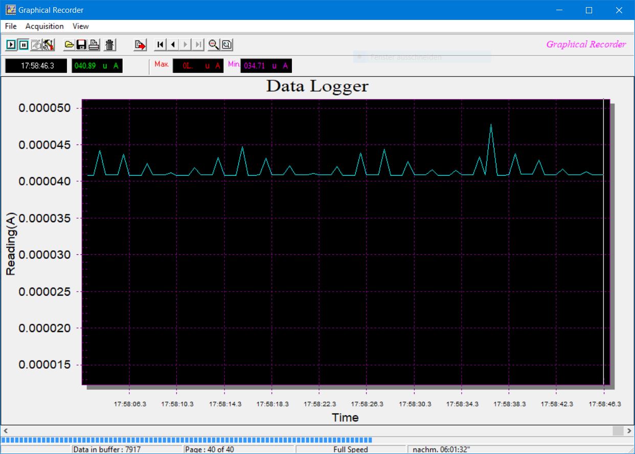

I bought a new DMM and captured some power usage data of my ttn node while in sleep mode.Has anybody an explanation what the reason is for those spikes around every 12 seconds?
put your application data (console) on the same screen then you know if its lorawan related
Probably the controller in the RN module waking up and going back to sleep.
its the unmodified cayenne LPP sketch…
