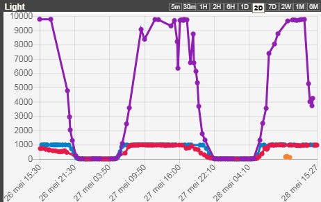

I don’t think it is related to the new sketch,
red and blue are oldskool december Cayenne sketches in a standard TTN node
purple is a TTN node with TTN sketch
Seems to me Cayenne code caps the reading at 1000
