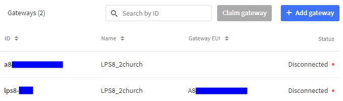

Dear descartes,
I’m trying to migrate my LPS8-gw to V3 but have two automatically generated entries (the V2-status is now “unkown”):
You warned not to delete a Gateway EUI.
I already switched to the v3-server address in the LPS8-configuration. What is the best way to continue?
Best regards, Thomas
What does the log on the LPS8 say - it is getting ACK’s back from the gateway server?
You may want to search the forum for LPS8 as there have been a number of different posts on that model of late.
