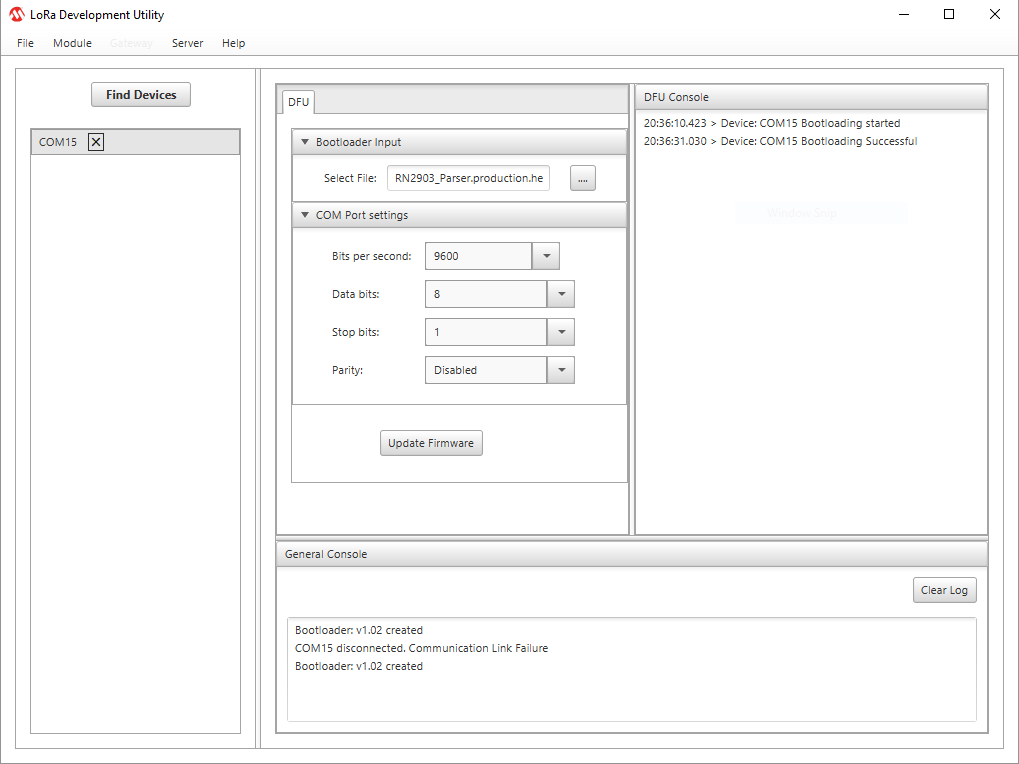

Ok, finally got it! Didn’t have to flash using PicKit this time at least. I used LoraDevUtility with the baud rate set to 9600 in bootloader mode and uploaded the offset hex file. Thanks everyone!
