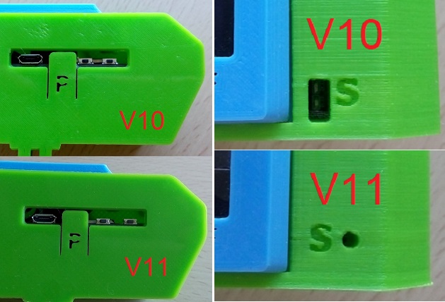

There are not so many changes in schematics / parts of the most recent T-Beam v1.1 revision for paying attention to.
However, the PCB layout has been altered a little bit. Which makes older 3D enclosure for v1.0 to be no longer appropriate for v1.1
This is an illustration of all the ā€˜exterior’ updates:
More details are available at this Thingiverse page .

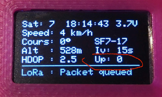

I have a question regarding the frame counter check. Do I have to reset the counter every time I restart the t-beam? I am using hottimucs mapper.
Is this the frame counter?

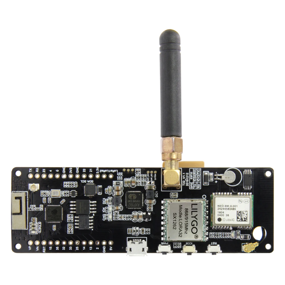

LilyGO direct AliExpress store has started to process orders on a new variant of the T-Beam board with most recent Semtech SX1262 LoRa radio IC:
  1. T-Beam SX1262 with ublox NEO-6 GPS module: AliExpress 1 2
  2. T-Beam SX1262 with ublox NEO-8 GNSS module: : AliExpress 1 2
It is expected to be Semtech ā€œLoRa Spaceā€ friendly in:
  • 433 MHz band variant - to operate with FOSSA Systems satellite(s)
  • 868 MHz band variant - to operate with Lacuna Space satellite(s)
This improved T-Beam is known to work nicely with TTN by means of port of BASICMAC (successor of LMIC) LoRaWAN library for Arduino IDE.

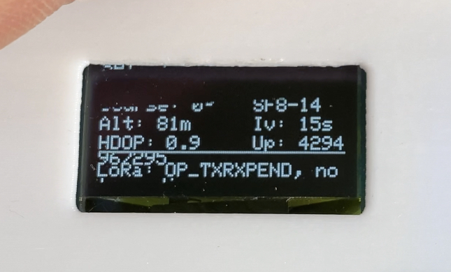

I need help in case of OTAA. It just stays on EV_JOINING. I am using the hottimuc mapper. It works with ABP, though. What could that be? The frame counter looks a bit odd, too. Do you still need to reset frame counter when using OTAA? When I choose SF8 it says ā€œOP_TXRXPEND, not sendingā€, what does that mean?

Sorry for the black bar on the top, that’s due to the refresh rate of the display.
