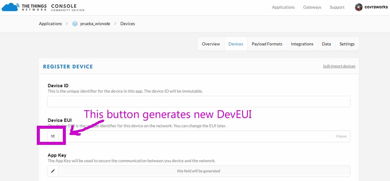

Hello I have just purchased a ttgo-tbeam. I’m trying to add it to the things network. I can’t seem to find the DevEUI on the device. Is there any other way to get the deveui if its not on the device?
TTN can provide DevEUI for you, Just press the button and number will be generate (you can change it later)
Thank you
