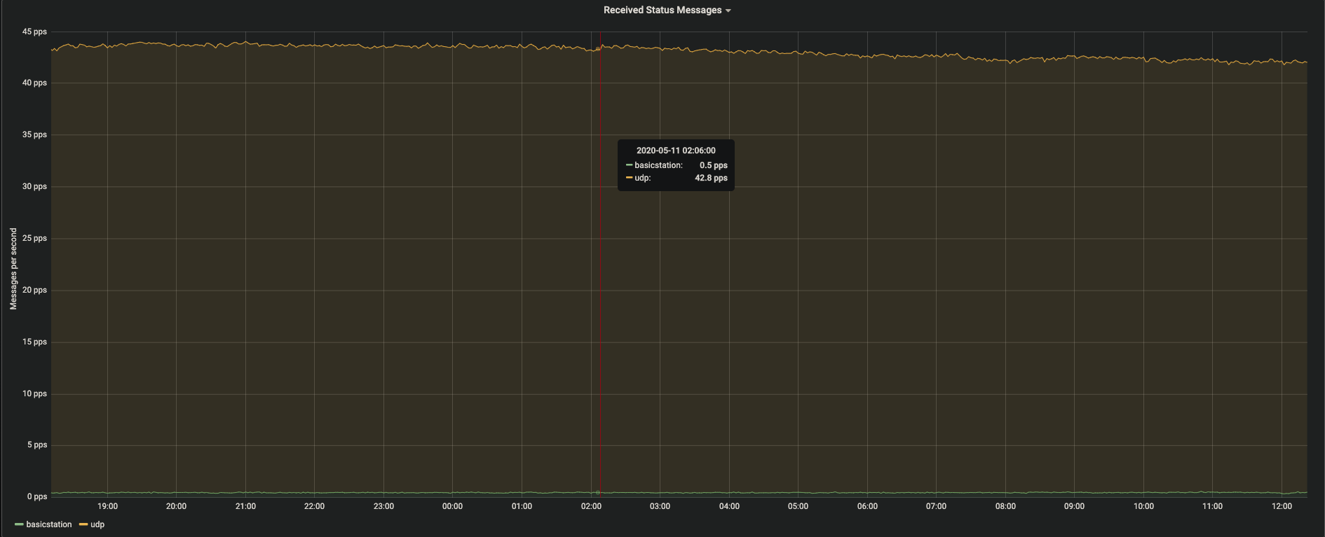

The received status messages is a strong indication of how often gateways reconnect and based on the graph below, it’s non-periodic and non-synchronised (as I expect).
Received Status message
[Excerpt from our metrics for the last 24 hours]
