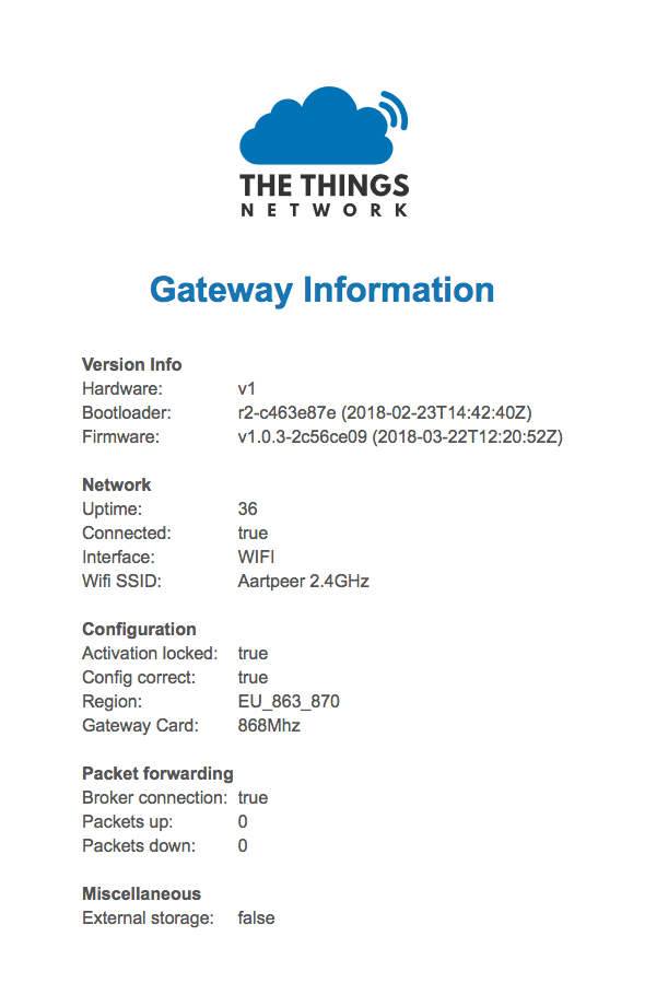

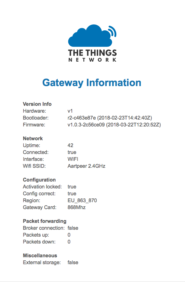

Noticed in http://things-gateway.local/info after installing .hex with PicKit IPE and configuring Gateway via https://activate.thethingsnetwork.org, all works for max 30 min. Then a bootloop occurs and “Broker Connection” won’t change to true.
first log after new instal & config:
08
After reboot:
55
Can’t get it to work anymore… :sob:
