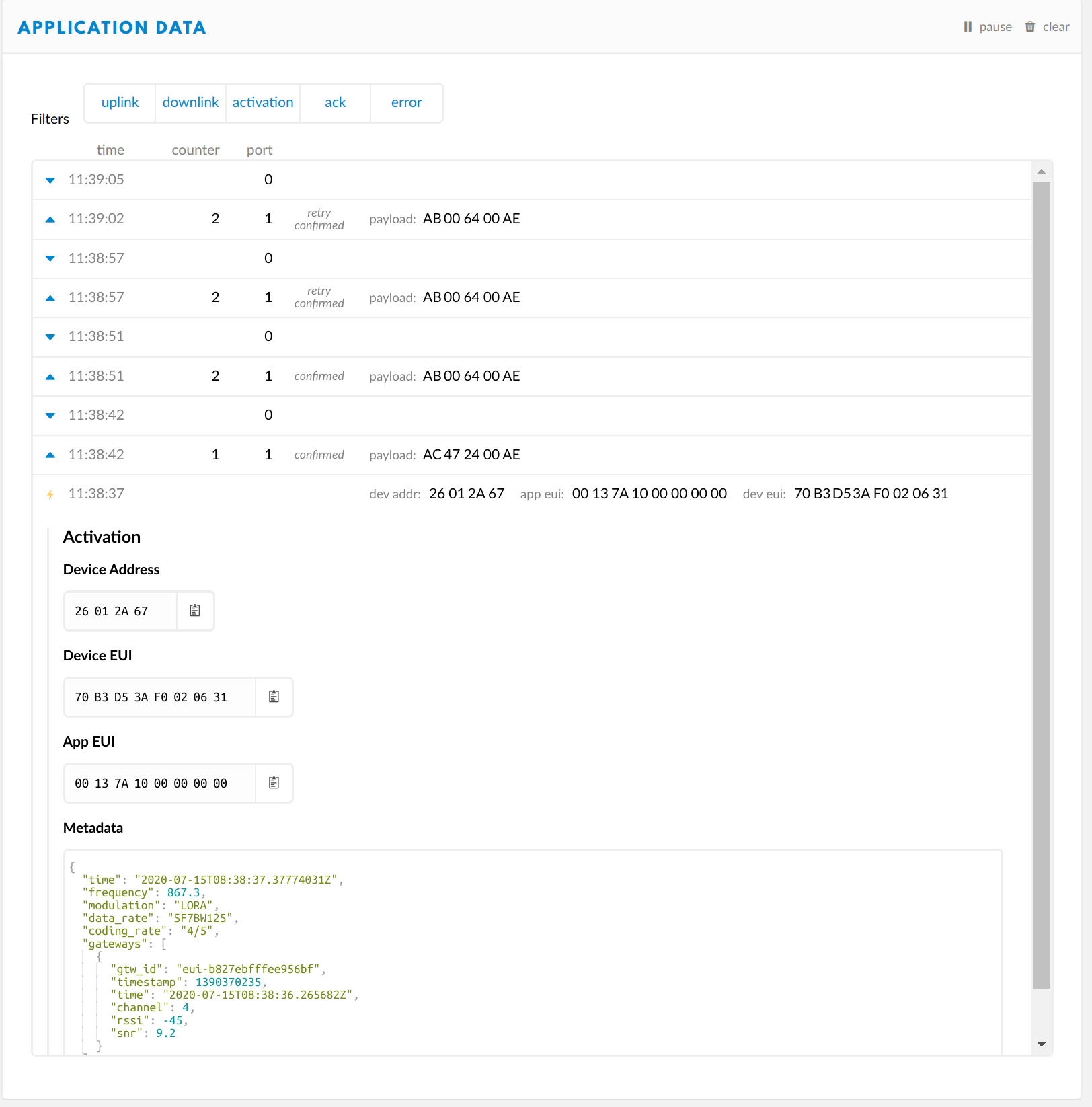

guys please dont give up on me, i have a response after placing a magnet( from subwoofer) on it. This the data i got
datastrings
what does this mean?

The data format is described in the first manual.
Also, you will need to find a way to disable the confirmation that the device requests: with the TTN Community network you’re only allowed 10 such confirmations per day, so that would limit the uplinks to 10 per day as well. I cannot quickly find that in the manual, so please ask your provider about that.

You node is connected to TTN and transmits data. However it seems the acknowledgment is not always received. Is your node too close to the gateway?
yes very close

Put it at least 25m away, it not, behind a brick wall 5m away.
Thank you guys for everything youve been really helpful, now i have to go read about “payload decoding”. if i have any problem ofcourse ill be back with a new topic. Again am grateful!
