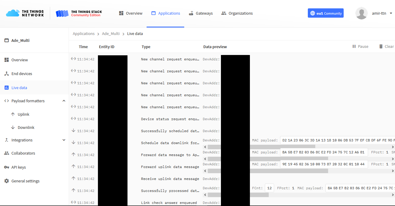

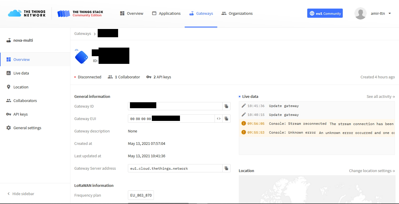

i was about to give up as I faced the same issue as bakir. i did all the steps mentioned here but the
gateway still disconnected(and it is still ).
however, just before I was about to delete the gateway and go back to TTN V2, I suspected an old
issue that used to happens in V2, which was a disconnected state on the gateway console but the
application console still receives live data. I configured an application and a device (with a
disconnected gateway status on the console). surprisingly, the same issue seems to be still
happening. i was receiving data from my sensor. unfortunately, TTN removed the gateway ID from the
meta-data hence I suspected that maybe another gateway around caught my packet so I disconnected
my gateway and retransmit again from the sensor but nothing received on the application’s live data.
So I guess that V3 maybe still suffers from that old problem.

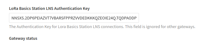

Can this LNS key be created once for all the GWs in the Personal API keys or in Org keyst, or does it have to be created per gateway?
Keys must be created for each gateway.
