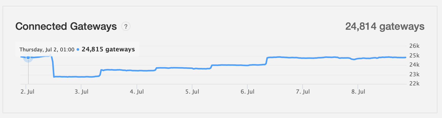

The issue, as far as I can tell from the information that I have gleaned & repeated above, there is an issue with certificates that had to be worked around with an update to TTS.
This mostly worked, but the network did see ~2,000 gateways drop offline which have been coming back in small batches. We don’t know what the criteria are for a TTIG to be included in a batch. We appear to be back to the original number of gateways online before the update and we can see the graph step up over the last few days:
Personally I’d restart my TTIG each morning and cross my fingers. If it is still not online by the end of the week we can regroup to try to figure out how to collate numbers & collectively report issues.
