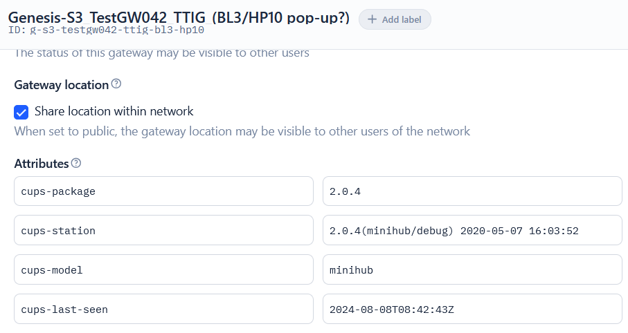

I also saw that my TTIG does not properly work today. It shows “connected” in console, but the logs from the gateway show: MBEDTLS: bad message length and SSL - An invalid SSL record was received. The “fallback” also does not work.
Yep, my TTIG died today as well. Is there a way to get it back online?
It looks like those old devices from 2020 with 2.0.4 firmware are now dead in the water…

Ditto here: seeing the reports earlier on the Forum I checked across my TTN deployed fleet tonight and looks like all recently active TTIGs I’ve looked at so far are offline :disappointed: FW 2.0.4 in each case. Even the normally bulletproof ones appear dead. Console show some as ‘Connected’ but closer check shows not seen for ~12hrs - basically around time of TTS update. Only one still physically here at lab/office so tried manual power cycle - no joy. Will leave all to see if they recover through normal 24hr CUPS check cycle but fact nothing happened with forced reset doesn’t leave me hopeful. Main problem with my fleet is many have been deployed over several years and whilst still actively providing TTN Community coverage many are in locations and hosted sites that I can no longer be sure of access to if any manual intervention or reset needed! Others are at sites where they get visited maybe once or twice a year most with no visits planned (many miles away!) for several months to come… I also looked at some other peoples known TTIG’s across various Communities and story the same so assumption its all TTIG’s/specific age of build likely correct. I just checked a ‘similar’ - housing and overall construction + BasicStation - Brown mini-pro deployed over in Florida and that appears working - states connection started ~13hrs ago - so likely around time of last TTS update to nam.

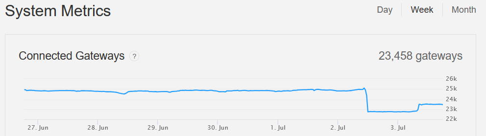

What ever was ‘fixed’ looks like around 1/3rd of dropped GW’s are now back, sadly not yet any of mine :frowning:
Yep… some more came back earlier this morning, but quite a few still missing.
Edit: Looks like mine actually came back as well earlier today!
Yep, a few hundred more bubbled up this morning inc. a small handful of mine - many still down - another 24hrs and check again?

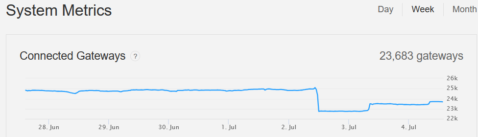

I can confirm my TTIG is also still offline following the July 2 maintenance. Like many others here, I see around 1000 fewer gateways shown on the official Network Status page compared to before the maintenance.
My device has been stuck in a connection loop. It is frustrating to see that while the status page says ‘Completed,’ a significant number of us are still without service. I am just one more statistic in this large group of affected users hoping for a resolution or an acknowledgment that this is a widespread server-side issue, not an isolated hardware/firmware/SSL failure.
