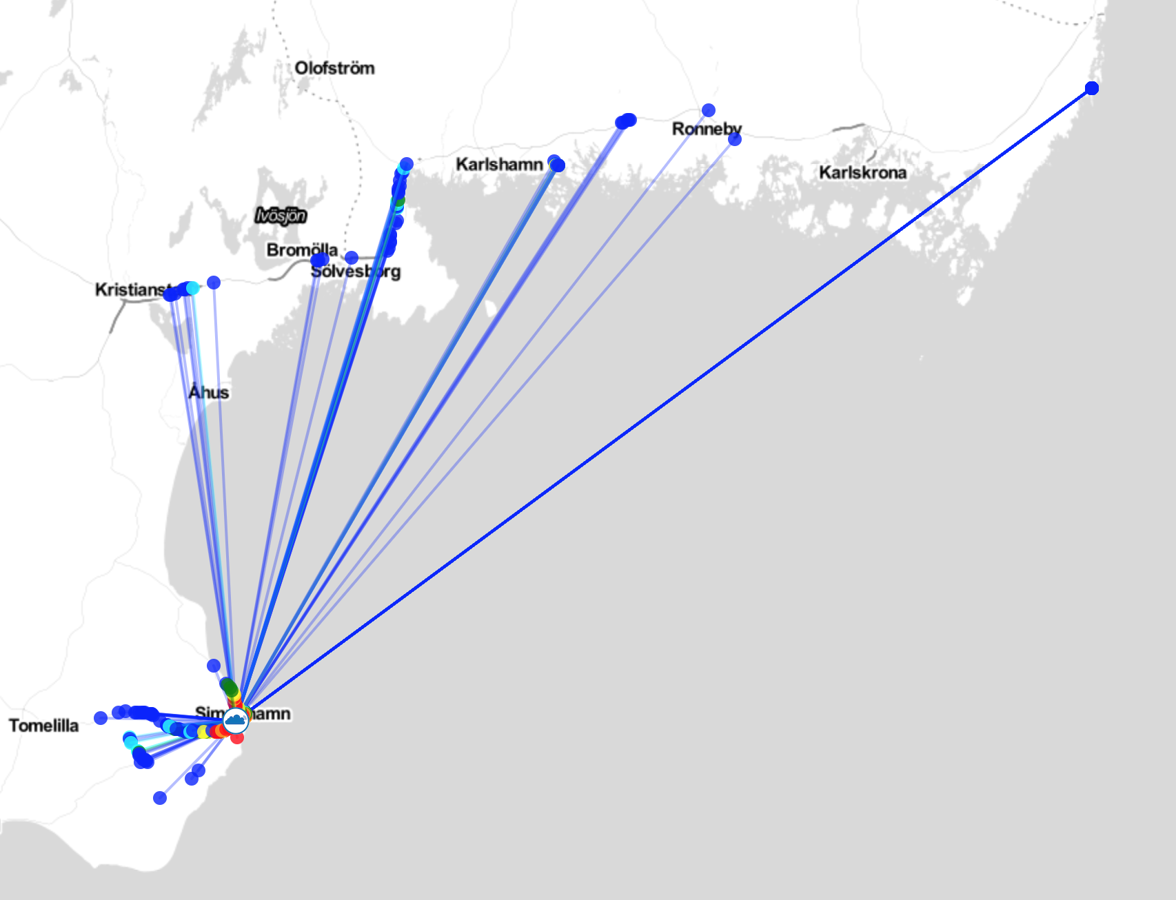

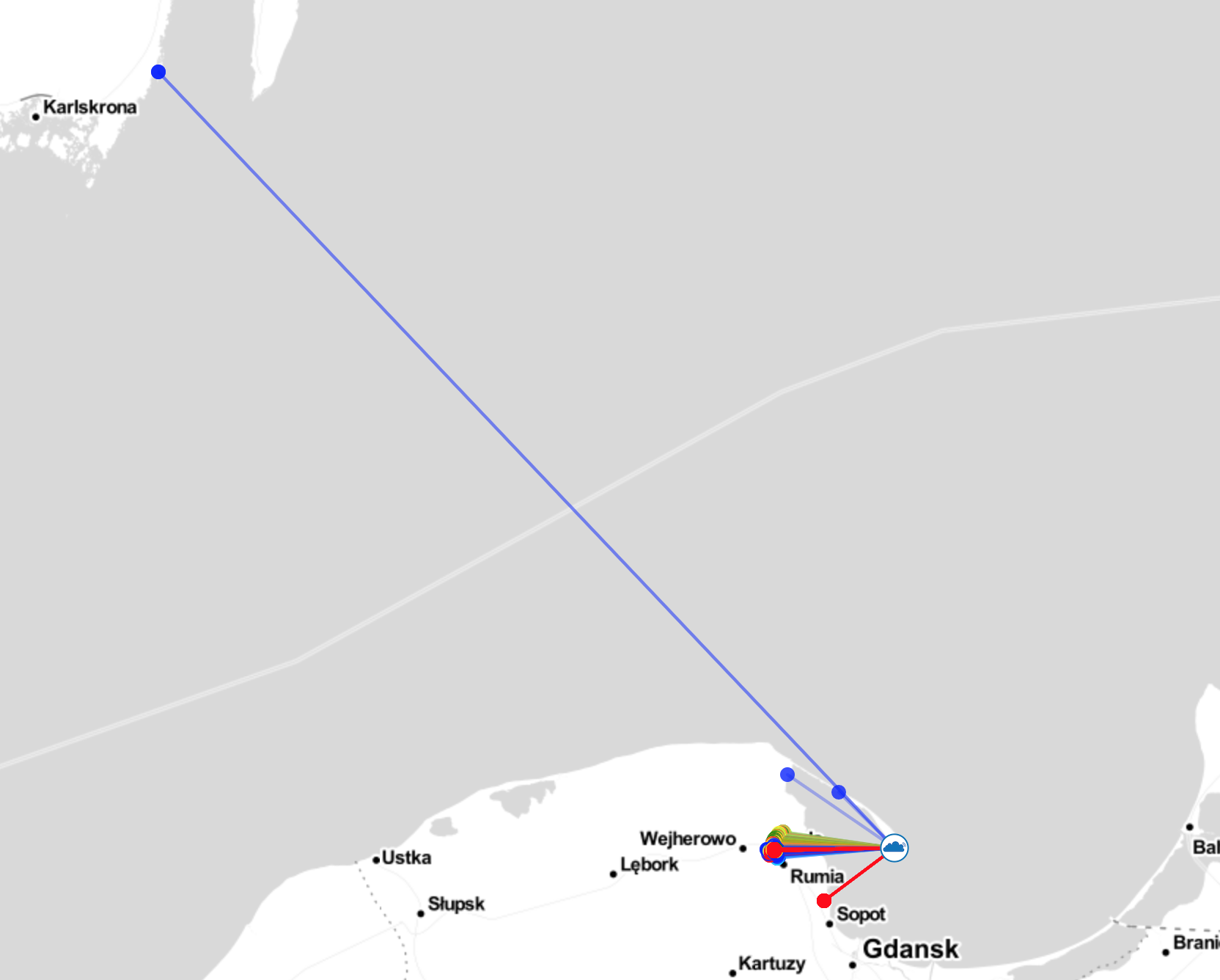

I had a ttnmapper enabled node mounted on the roof of my car when driving around in the south east of Sweden. At one time a couple of packages were picked up by a gateway nearby Gdansk in Poland 252km away!? Should this even be possible? My node was at sea level, and I assume that the gateway wasn´t airborne.
In addition to this, some packages were also picked up by a gateway in Simrishamn ( 132km away )
It only happened once, I tried to repeat it the next day without success.
Anyone seen this before? Any atmospheric phenomena or something that made this possible? Weather?

Aside: looking at all results for a gateway may give some clue if its coordinates are set okay. It seems they are okay:
TTN Mapper
Same goes for the other one:
TTN Mapper

Hi @LinusEricsson, assuming no fakery, it’s likely that this was due to transient Tropospheric Ducting.
Also search on Google Images for “tropo scatter”. It’s widely used for long-distance low-capacity radio and much-loved by military but is very unpopular with regulators.
