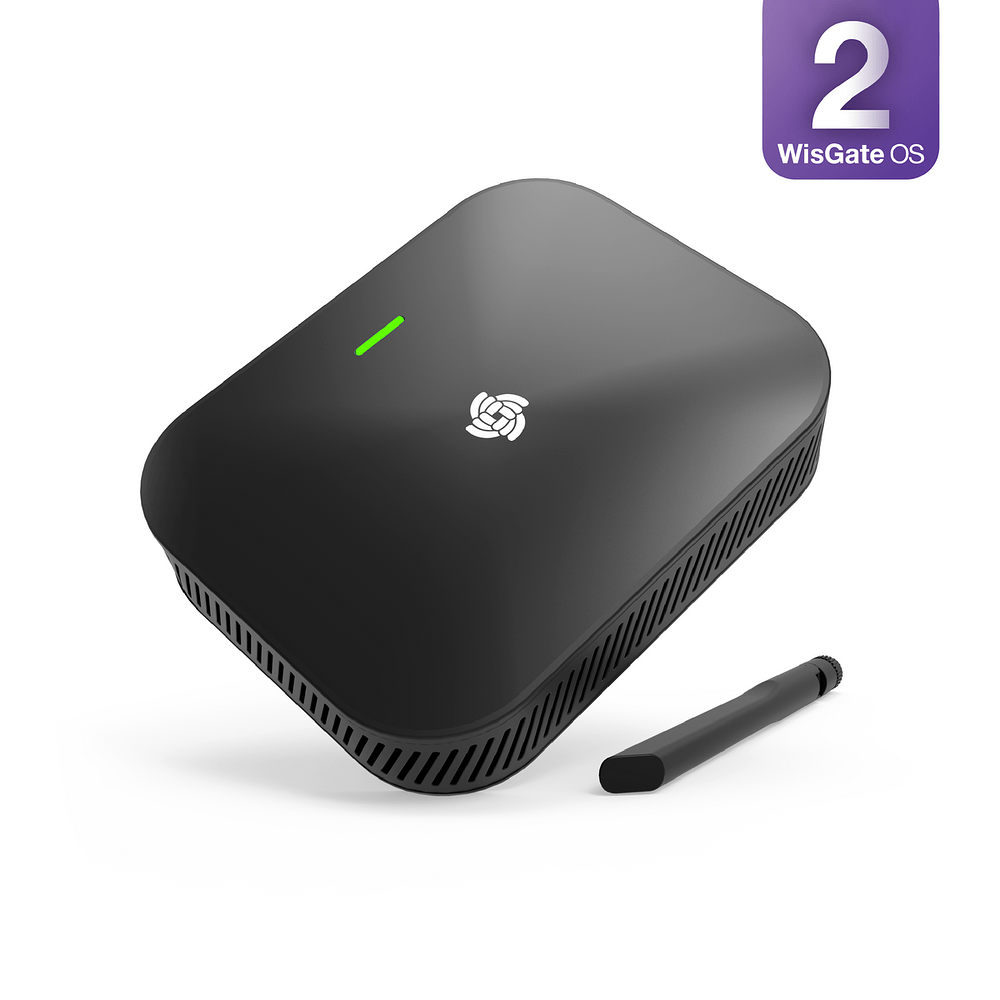

Often worth checking with our friends over at RAK - nte sure a Pi based 433 currently available but there is always something like this (Believe there is an EU433Mhz option):

I have looked at RAK, I found links else where in this forum to the 831, which looks to have been superseded. Sadly the link on RAKs page for the 831 led to another device from them that mentioned 868 and 915, but nothing about 433.

The 831 replacement RAK mention on the 831 page is the 2245, but the link takes you to a page for the 5146 which 868/915/920 etc
I’ve contacted RAK to find out what device they recommend,
For anyone who finds this thread, there is a 5146L which is 433
