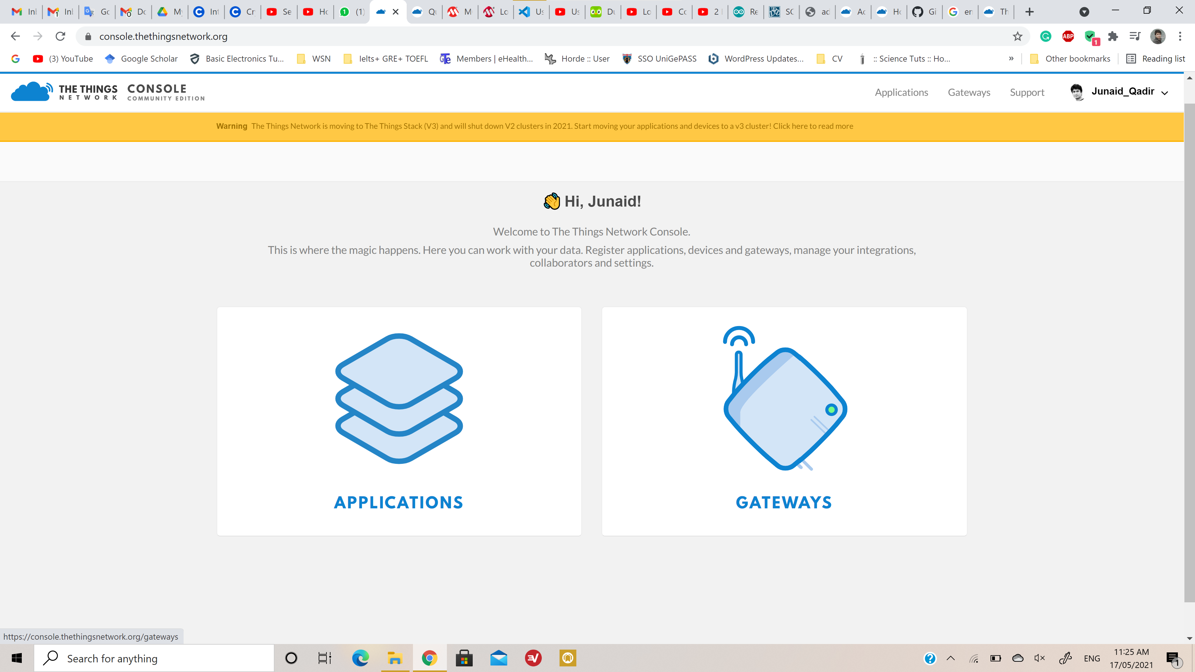

Sir, could you please let me know how to change the version of ttn console? Is the below screenshot v2 or v3 console?
That looks like the V2 console. You are OK to stay in V2 for the next few weeks. At some point V2 will become read only. It will still work but you will not be able to add new gateways or nodes.

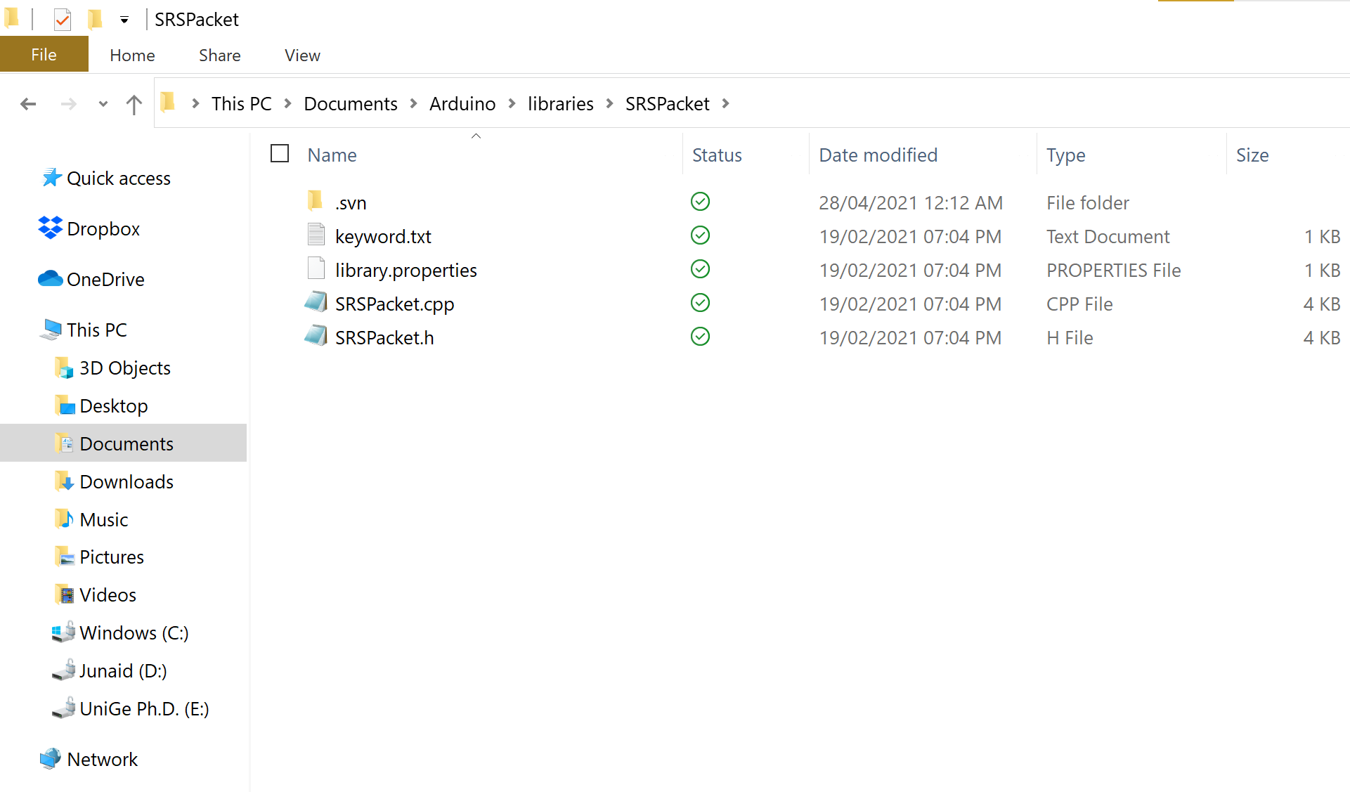

Where is this library from: #include <SRSPacket.h> - this is important as there is no way to know what the size of the payload is without knowing what this code does.

Dear Sir, the SRSPacket.h library is included in the separate folder of this code.

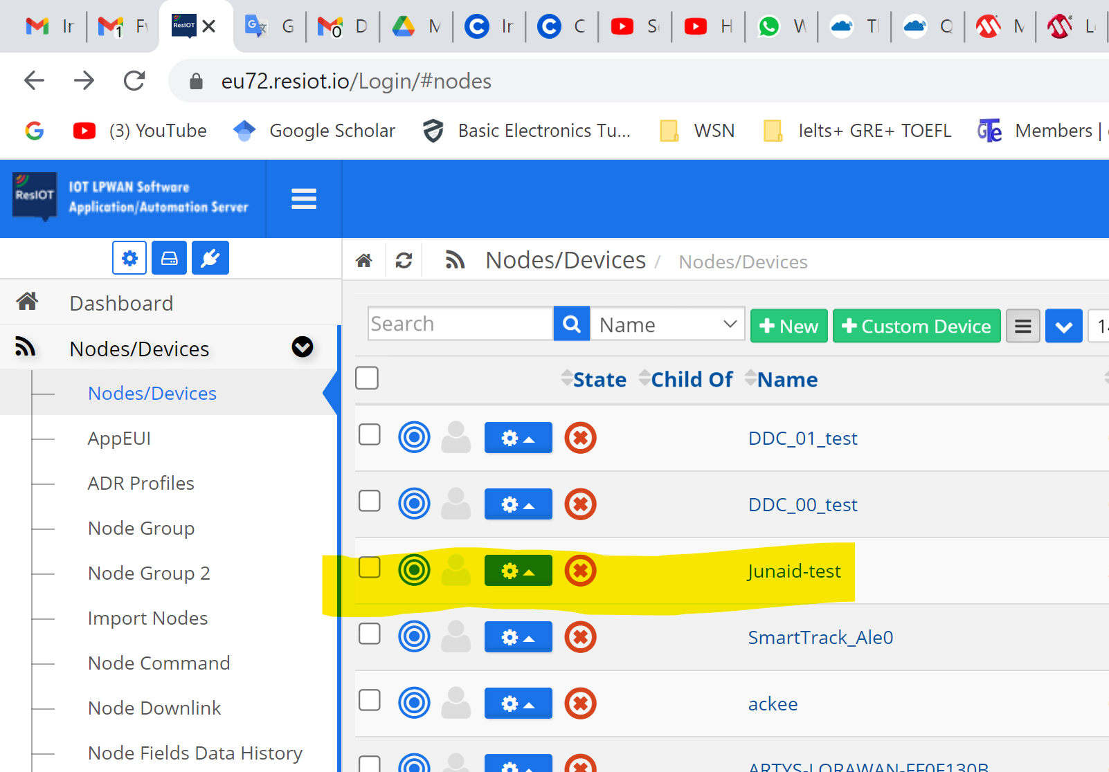

Last time, it was tested on resiot lorawan (ResIOT Login - ResIOT LoRaWAN Network Server and IoT Platform) platform and it was working fine with this code. But the only problem is with the ttn.
