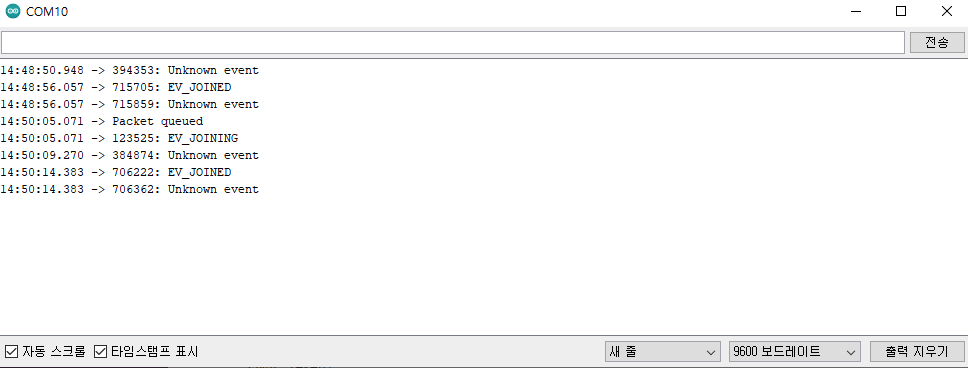

My code is as below.
I wrote the code for sending data every five minutes, but the COMPLETE code didn’t come up at all
Is there a problem with my code?

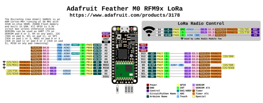

// Pin mapping
.nss = 8,
.rxtx = LMIC_UNUSED_PIN,
.rst = LMIC_UNUSED_PIN,
.dio = {3, 5, LMIC_UNUSED_PIN},
Uart Serial2(&sercom5, A5, 6, SERCOM_RX_PAD_0, UART_TX_PAD_2);
void SERCOM5_Handler()
Serial2.IrqHandler();
//no2
Uart Serial3(&sercom1, 12, 10, SERCOM_RX_PAD_3, UART_TX_PAD_2);
void SERCOM1_Handler()
Serial3.IrqHandler();
//so2
Uart Serial4(&sercom0, A4, A3, SERCOM_RX_PAD_1, UART_TX_PAD_0);
void SERCOM0_Handler()
Serial4.IrqHandler();
