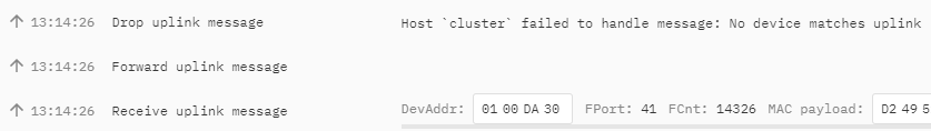

Now all forwards are dropped.
Drop uplink message - Host cluster failed to handle message: No device matches uplink
I am guessing this is an issue on the node side. Not my node, I am just hosting a gateway.
The node it not setup for V3? I thought Packet broker was supposed to support V2 and V3…
That’s informational. It just means there is no node with matching address (and keys) registered in the backend. Might well be traffic from a node on V2, a private network or a commercial network.
Addresses starting with 00 / 01 are usually private networks.
