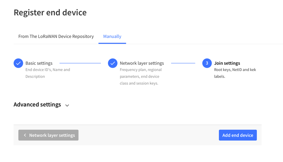

Up until now things go swimmingly and in line with what I see on video’s and on the web, however, the fun starts in the Join Settings section…no where to add an AppKey for my device, just an expanded “advanced settings” menu asking for things like “Hone NetID” application server ID?

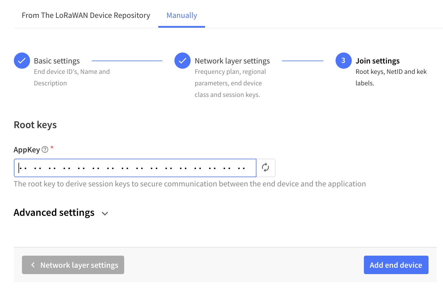

When I add a device, the first layout is Basic settings, then Network layer settings and then Join settings.
The last layout has a heading of Root keys and has the AppKey under it:

How weird, I am missing the Root keys bit, I see the steps and below the Advanced settings.
I have tried different browsers and they give the same result, this might be a bug, cannot think of something in the config of the stack which would cause this but I could be wrong

And at the step 3 Join settings the Root keys section with the input for entering the AppKey is missing completely as described by @City028.

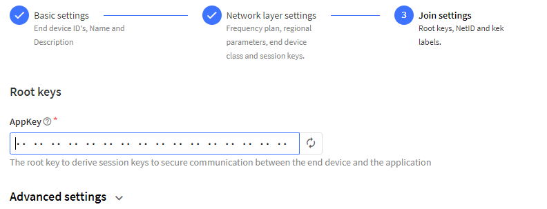

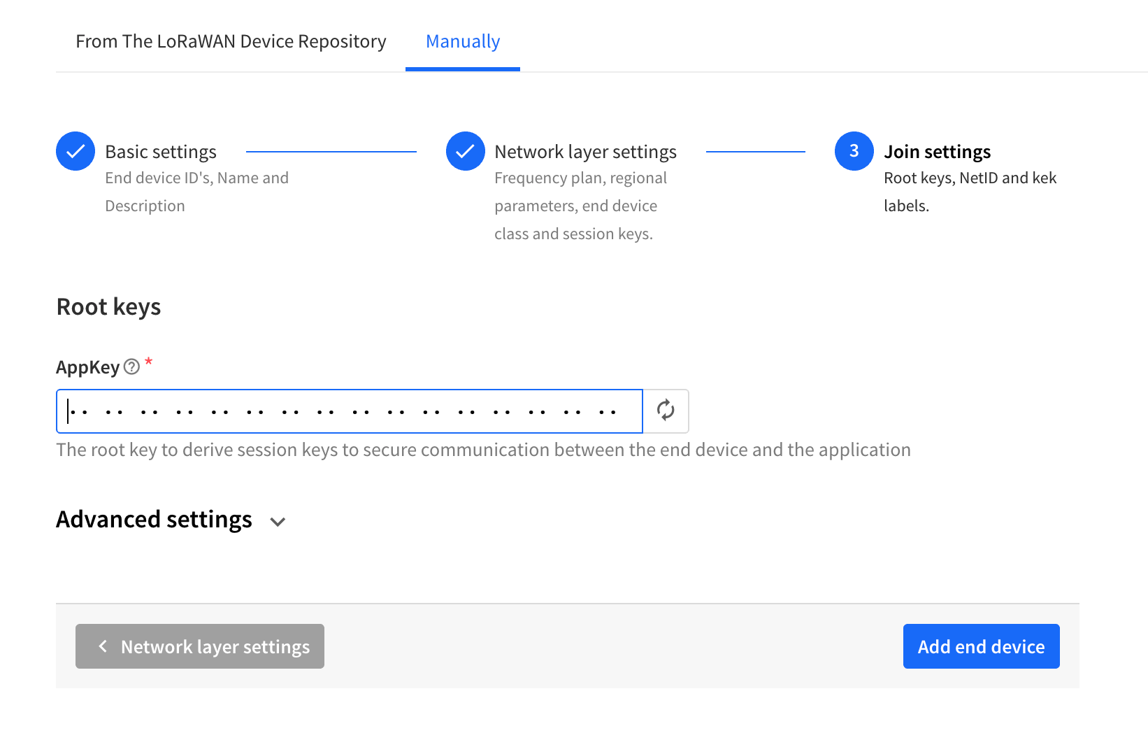

If I add the Edit device keys in application permission to the user, reload the page and manually add a new device the warning at the beginning disappears and the Root keys section appears back as normal:
