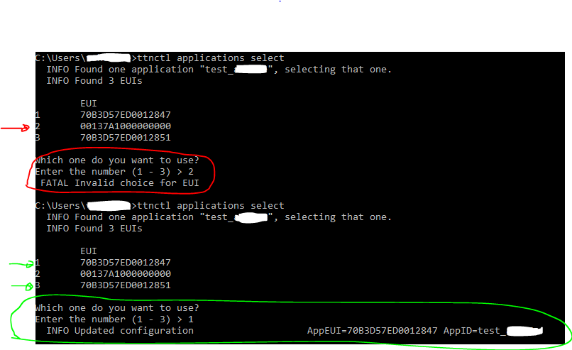

Tried getting my App to use AppEUI #2 (the one that is hardset by manufacturer of devices i use) - getting an error…
Tried using default AppEUI- works,…tried using 3rd AppEUI - generated by TTN as well - works…
