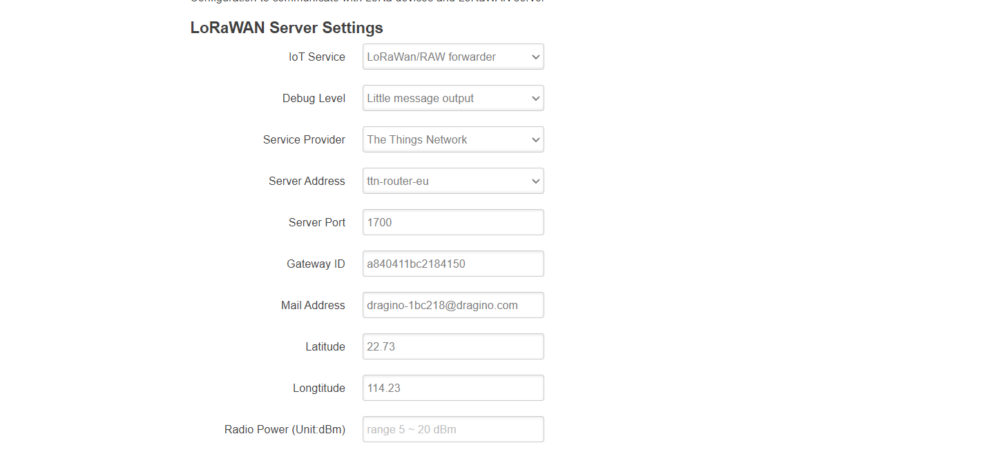

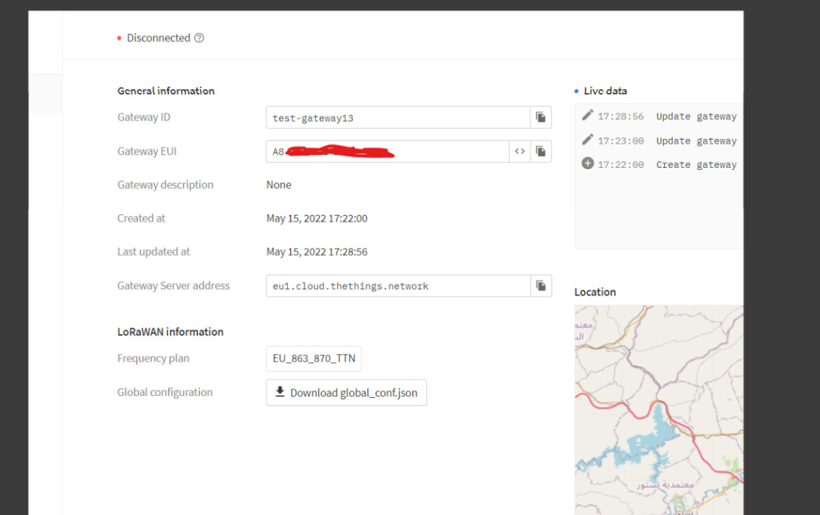

i am trying to connect my gateway to thethingsnetwork ,but its showing disconnected .
i followed the instruction and the problem is still there .
Use the custom option in stead of TTN and enter the details as provided in the TTN console for gateway address and 1700 for port.
thank you very much
it worked perfectly
