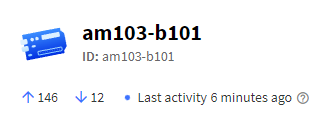

Updated the CO2 sensor a little over 24 hours ago such that it doesn’t send anymore LinkCheckReq uplinks.
Number of downlinks is still a little on the high side…
@descartes does this align with your observations wrt no. of uplinks? I could leave a console running for a couple of hours again.
Or is this behaviour decent for an ADR enabled device?
Seems a bit much - but about what I normally get - a few uplinks, then a couple of downlinks saying they are to set Rx1, then all quiet for a few more hours, rinse, repeat.
As the test device I started on Monday dropped straight down to DR5 power level 2 within the first few minutes and wasn’t moved, I can’t see why it would need further downlinks.
I’ll trawl through the JSON console captures this evening to see if I can learn more.
