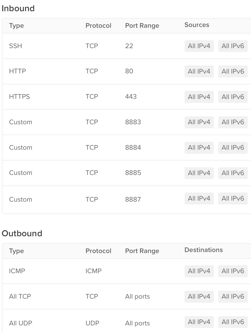

Firewall Config
Fine if local testing and LNS on same local network as GW but by backhaul what we are interested in is the internet connection service provision from the premise (Office/Home to “The Internet” and ultimately the cloud service where remote LNS is hosted), so equivalent to say BT, Virgin Media, Vodafone or any of >100 AltNets here in UK, Verizon or Comcast or… in US, France Telecom, Bouyuge Telecom, Free, Orange… in France, Swisscom, Deutch Telecom, Fastnet, SingTel, or whoever is your internet communication service provider in your geography :slight_smile:

tcp        0      0 0.0.0.0:8884            0.0.0.0:*               LISTEN
tcp        0      0 0.0.0.0:80              0.0.0.0:*               LISTEN
tcp6       0      0 :::443                  :::*                    LISTEN
tcp6       0      0 :::1883                 :::*                    LISTEN
tcp6       0      0 :::1882                 :::*                    LISTEN
tcp6       0      0 :::1881                 :::*                    LISTEN
tcp6       0      0 :::1887                 :::*                    LISTEN
tcp6       0      0 :::1886                 :::*                    LISTEN
tcp6       0      0 :::1885                 :::*                    LISTEN
tcp6       0      0 :::1884                 :::*                    LISTEN
tcp6       0      0 :::8883                 :::*                    LISTEN
tcp6       0      0 :::8882                 :::*                    LISTEN
tcp6       0      0 :::8881                 :::*                    LISTEN
tcp6       0      0 :::8887                 :::*                    LISTEN
tcp6       0      0 :::8886                 :::*                    LISTEN
tcp6       0      0 :::8885                 :::*                    LISTEN
tcp6       0      0 :::8884                 :::*                    LISTEN
tcp6       0      0 :::80                   :::*                    LISTEN
tcp6       0      0 :::22                   :::*                    LISTEN
Hope I have answered all the questions asked.
Curious that I could not see 8887 port listening for connection in the command line log but I could see the port 8887 appearing in netstat.
Is this an issue in the configuration in YAML?
@descartes @Jeff-UK
Any direction or help is much appreciated?
