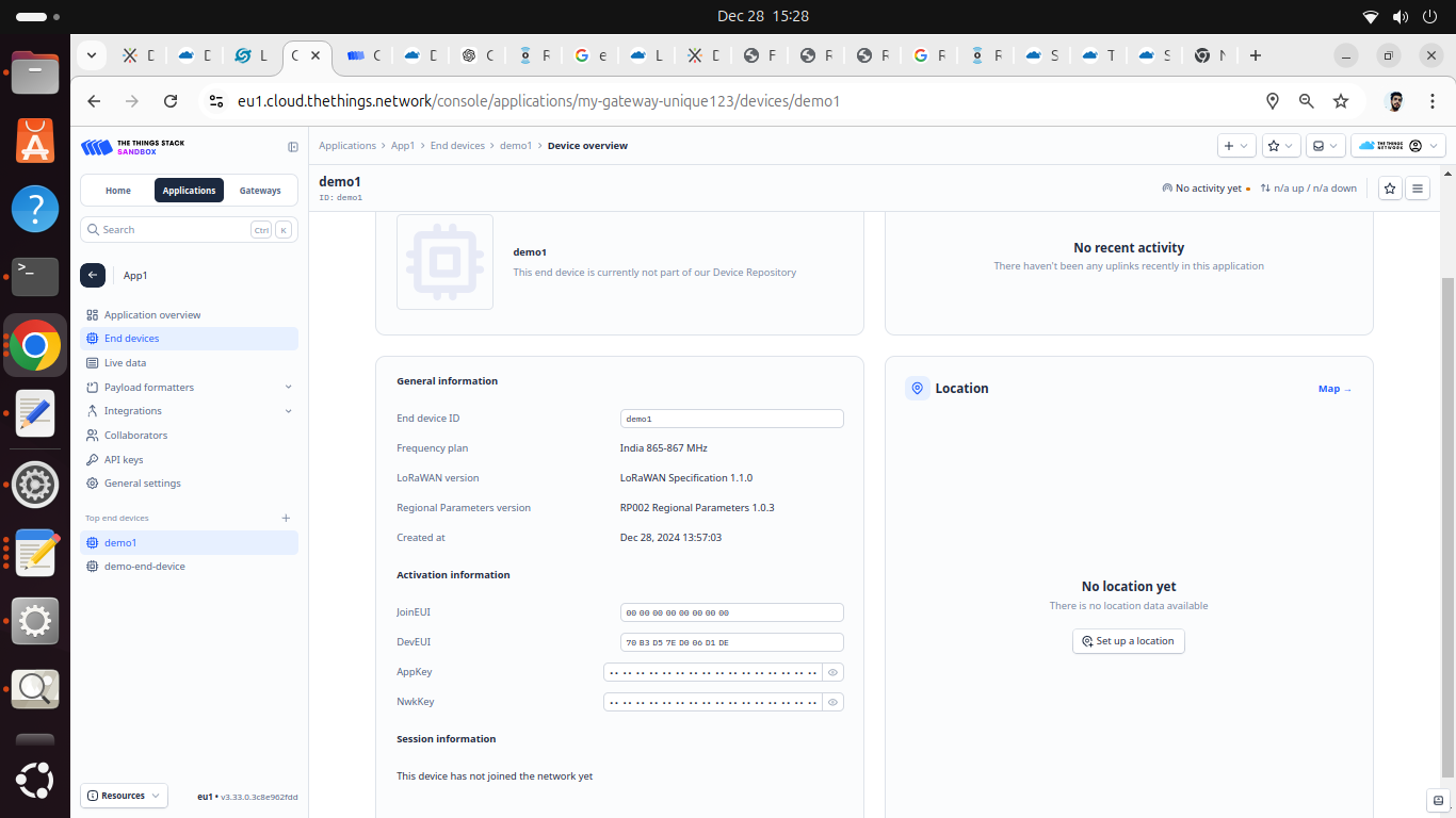

Title: Issue Adding End Device to Network: “Device Not Part of Device Repository”
Description: Hello,
I’m facing an issue while trying to add an end device to my network. I’m using the Dragino DLOS8N gateway and a LoRa V1.1 device, but when I attempt to add the device, I receive the following message:
“This end device is currently not part of our Device Repository.” “This device has not joined the network yet.”
I’ve ensured that both the gateway and the device are properly configured, but the end device does not appear to join the network successfully.
Here are the details:
  • Gateway Model: Dragino DLOS8N
  • Device Model: LoRa V1.1
  • Firmware Version: (Include firmware versions if known)
  • TTN Network: (Specify if you are using the public TTN network or your own)
I’ve checked the following:
  • The device and gateway are powered on and within range.
  • The LoRa device is correctly configured with the appropriate device EUI and keys.
  • The LoRa gateway is connected and has internet access.
can you plese help me
Do not double post - it splits volunteers efforts and fragments answers making it harder for others to find later. Will leave your other thread comment on same topic open and close this one. For ref if not a device in device repository the LNS will not know how to set e.g. decoder or LoRaWAN RP/Spec (1.02, 1.03. 1.1 etc.) - so simply follow the manual configuration options for your (unknown) device!
Also for both your posts you appear to have hijacked unrelated threads - again dont; rather search for appropriate thread or start a fresh one…
