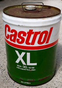

is the drum horizontal or vertical placed, what are the exact measurents, what material.

The 20l drum is like the one below but laying on it’s side sitting on a post. No worries about drilling a hole into it. Some people seem to have the urge to drive over them!

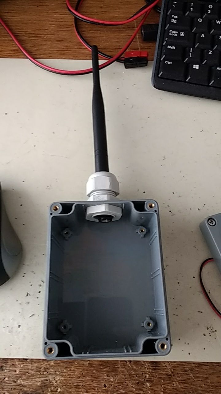

I’m still not clear on how “The Ground Plane Antenna” section in the more info document works (something about impedance) but it seems if it is directly connected to the RFM95W module then it needs to be above the drum. An esp32 will be under the module and there will be a usb power bank there too. I’d probably prefer to attach a 100 mm pvc cube (electrical junction box) to the top of the drum, even if I need to put a new flat ground plane disk in the junction box.
