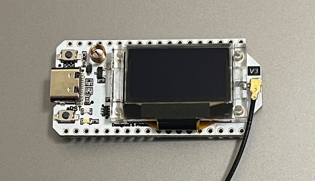

Hi, I am trying to connect my Heltec WiFi LoRa 32 (V3) to TTN. I have a personal gateway using the RAK5146 and a Raspberry Pi 5. I have already connected my gateway to TTN. However, I cannot connect my Heltec. I used this method to do it, but it didn’t work. When I build in Arduino IDE, it looks like it builds successfully, but nothing appears in TTN.
What can I do?
You should give more detail on what the errors showed on the Serial Monitor when Heltec runs.
Hi, I can see this in my serial monitor. I generate the DevEUI and AppKey using TTN generator.
