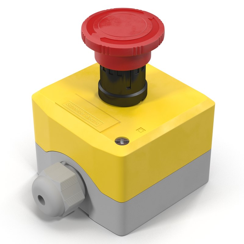

This is some example of an industrial grade push button:
But like for the elevator button any logic and LoRaWAN connectivity will have to be added separately.
Thanks. The image you posted is the sort of thing I am after. I don’t intend to use it with an escalator or as part of a critical system I merely wanted people to be able to visualise it.
I don’t want to have to add a LoRa transceiver to it as I will be deploying around a hundred. Are you aware of buttons out there?
