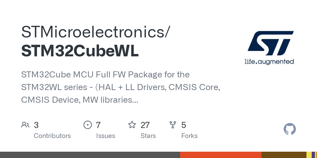

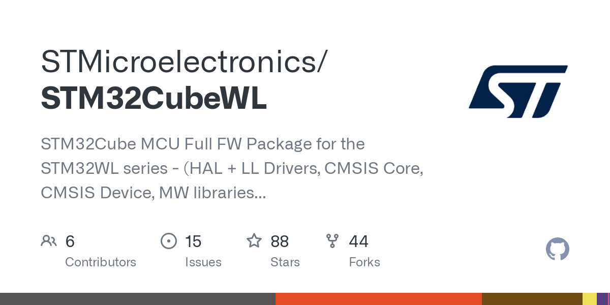

In addition to anything there may be for the ā€œgeneric nodeā€ ST publishes examples with a LoRaWan stack for the Nucleo with this chip
I just checked out that device, and it looks really promising! I’m curious to see the consumption specs.
I’m having a tough time finding example code on the ST website for the LoRaWAN STM32WL part. I’ve gone through the YouTube training doc which gives me high level stuff. It looks like mbed-os supports that chip as well, so maybe I can find something there.
And within that for example
Projects/NUCLEO-WL55JC/Applications/LoRaWAN/LoRaWAN_End_Node
Huge thanks! The API doesn’t look bad aside from the ridiculous amount of initialization code. I’ll have to learn more about the CubeIDE to see how much of this is generated (and how to generate it).
This project supports the WLE (it’s the same radio peripheral as on the WL).
Not really any ā€œgenerationā€ needed, the files are all there they just need to be fed to a compiler and linker.
I was able to throw together an alternate build flow by identifying likely files and include paths and adding them bit by bit to resolve each new build error. That was a test for a client project so they not I own it, but it was a fairly rote and reasonable process of sweat equity.

has anyone adapted the WL55-LoRaEndNode-Software to the hardware STM32WLE in CubeMX?

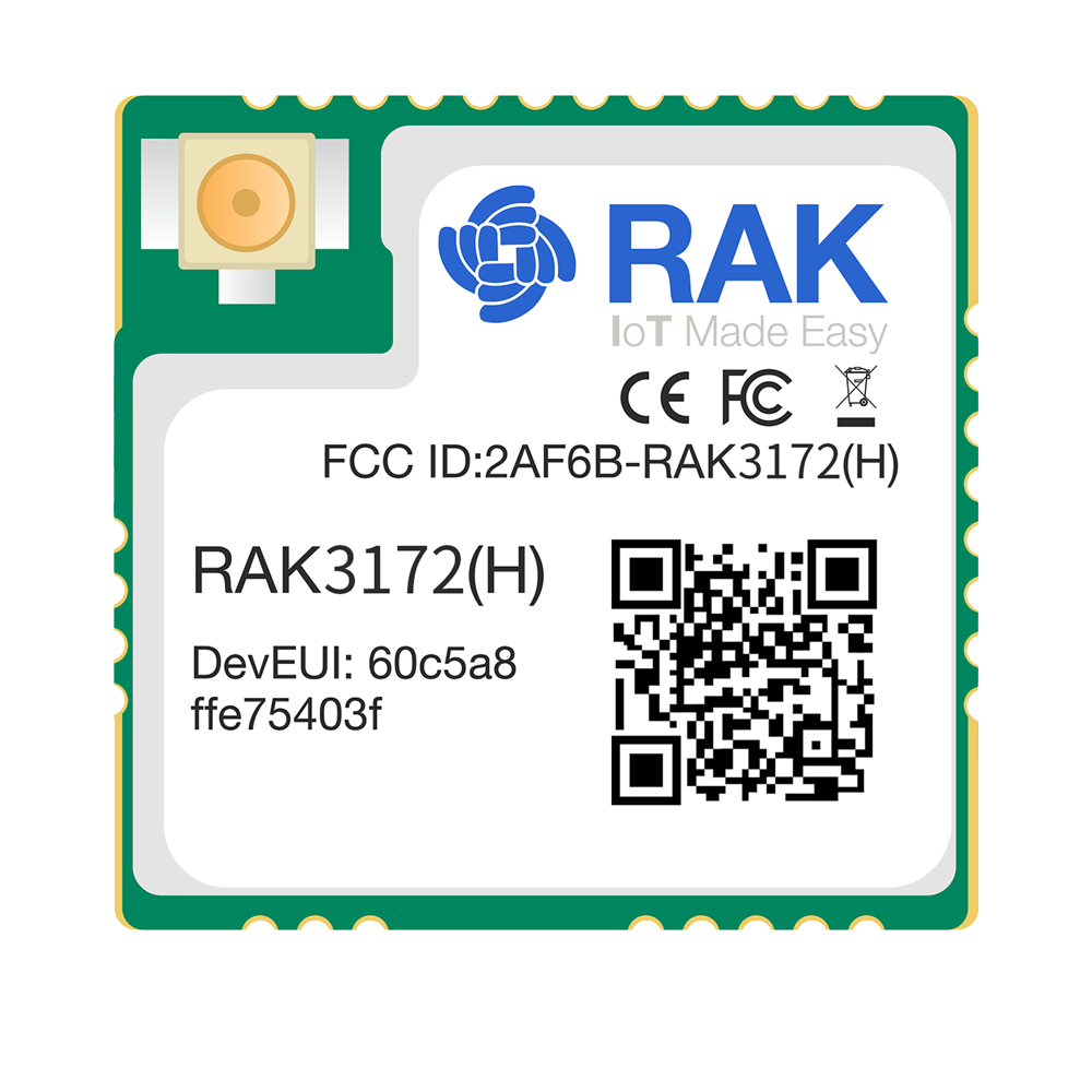

Dear @E_T I think you could find usefull this RAK document:
Thank you!

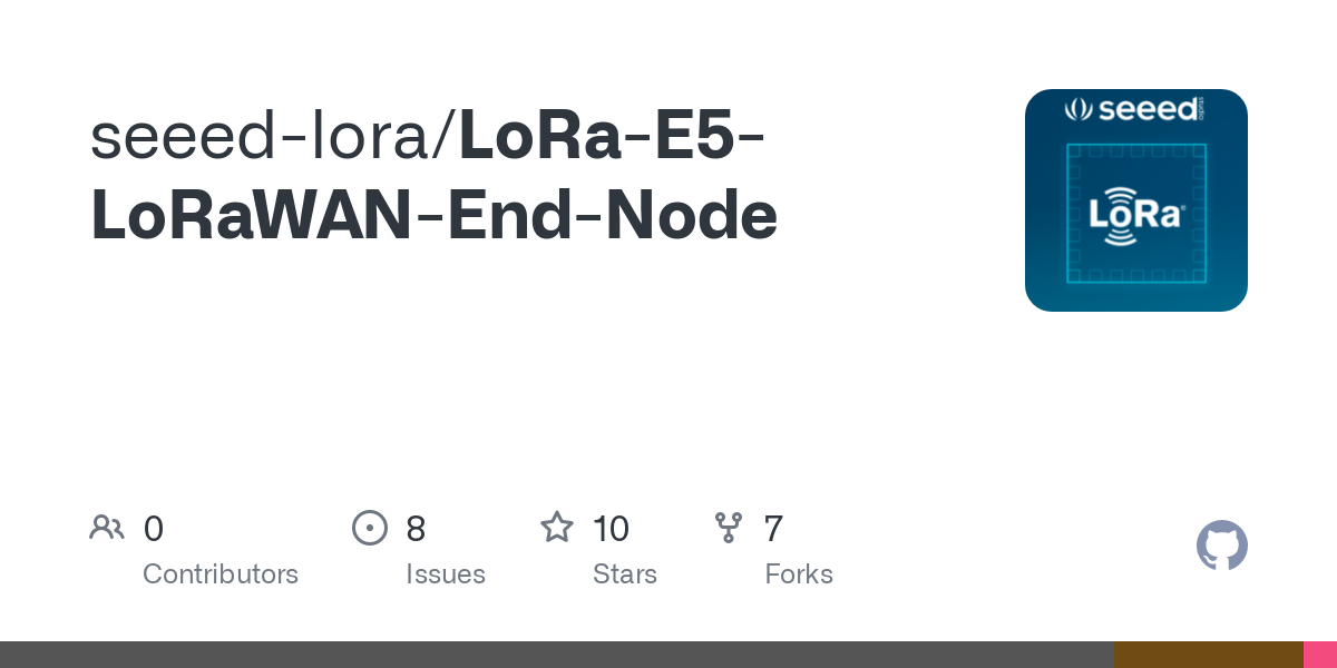

The past week I’ve been looking at this example for the Lora E5 module which has an STM32WLE5JC in it:
Unfortunately this project isn’t a good example as the modifications was hacked in, and regenerating the code from the .ioc file breaks the project. I believe the RAK example is much cleaner, so I will try that one now. Thanks for sharing @jfmateos
I haven’t gotten Arduino working on any of my STM32WL boards yet. Currently the best example using STM32Cube is GitHub - danak6jq/Seeed-LoRa-E5: LoRaWAN end node built from scratch using CubeMX for WLE5x in the LoRa-E5. The other good one is the official MBed LoRaWan example, using custom targets, as described in GitHub - hallard/LoRa-E5-Breakout: LoRa-E5 Breakout board
