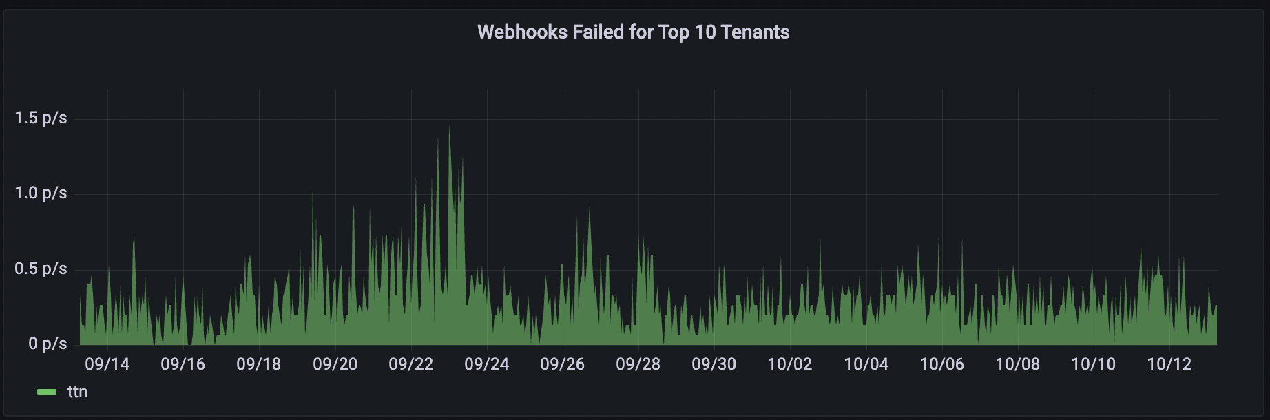

I’m also wondering why this break wasn’t detected by TTI after the update. My webhooks started failing, so this should have shown up on TTI’s metrics.
Screenshot 2022-10-13 at 08.29.23
Our metrics did not pick up a huge drop. TTS CE traffic is so massive these days that small drops are difficult to track without our alerting system constantly blowing up.
Items like this shouldn’t be tracked by metrics; I have some solutions for that which I’ll look into with the team.
