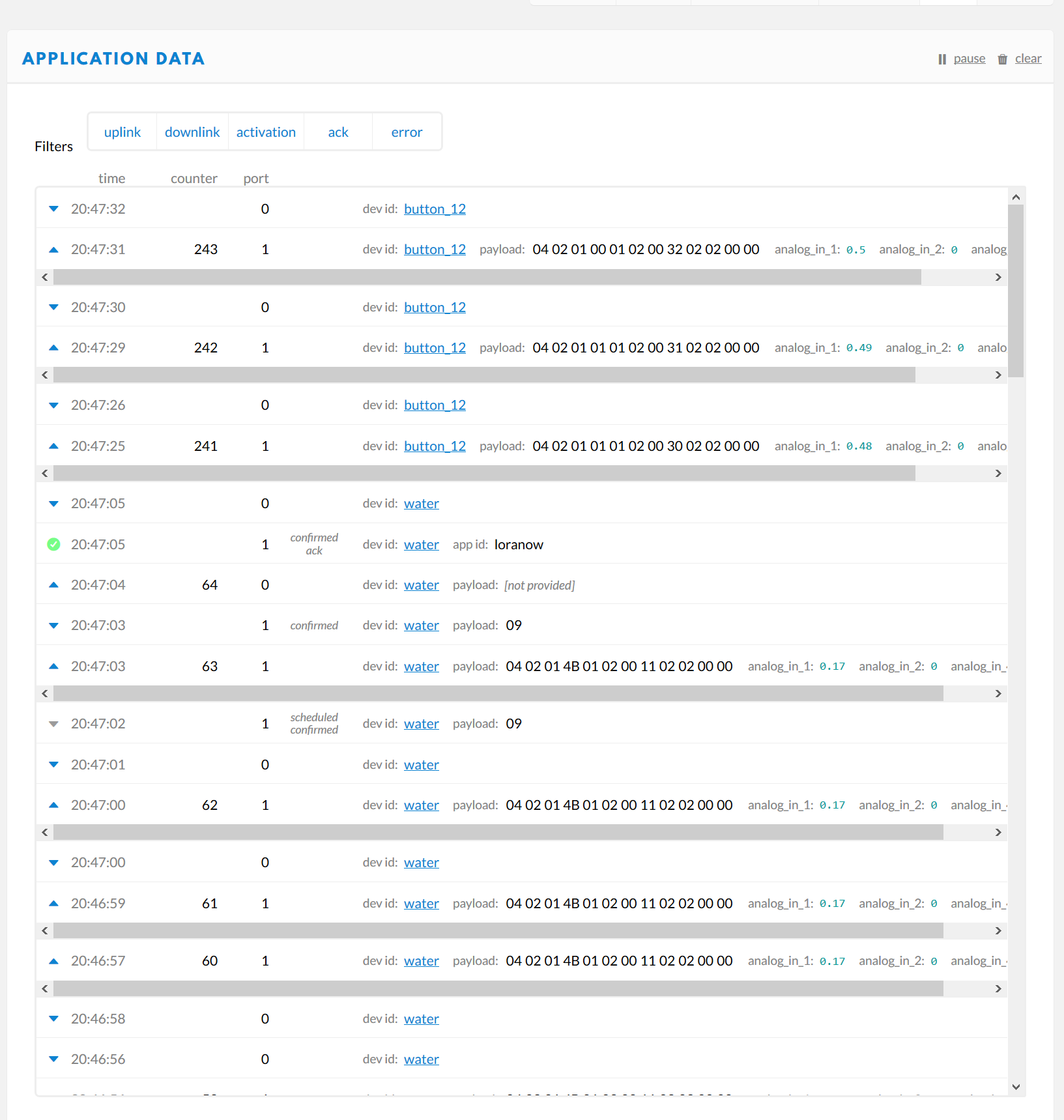

My application has a strange behavior, every uplink the application sends back a downlink.

I guess is a MAC problem. The application is send me a MAC command LinkADRReq and the node is send the next uplink the MAC command LinkADRAns to confirm the command.
But the server continuous sending the MAC command.
