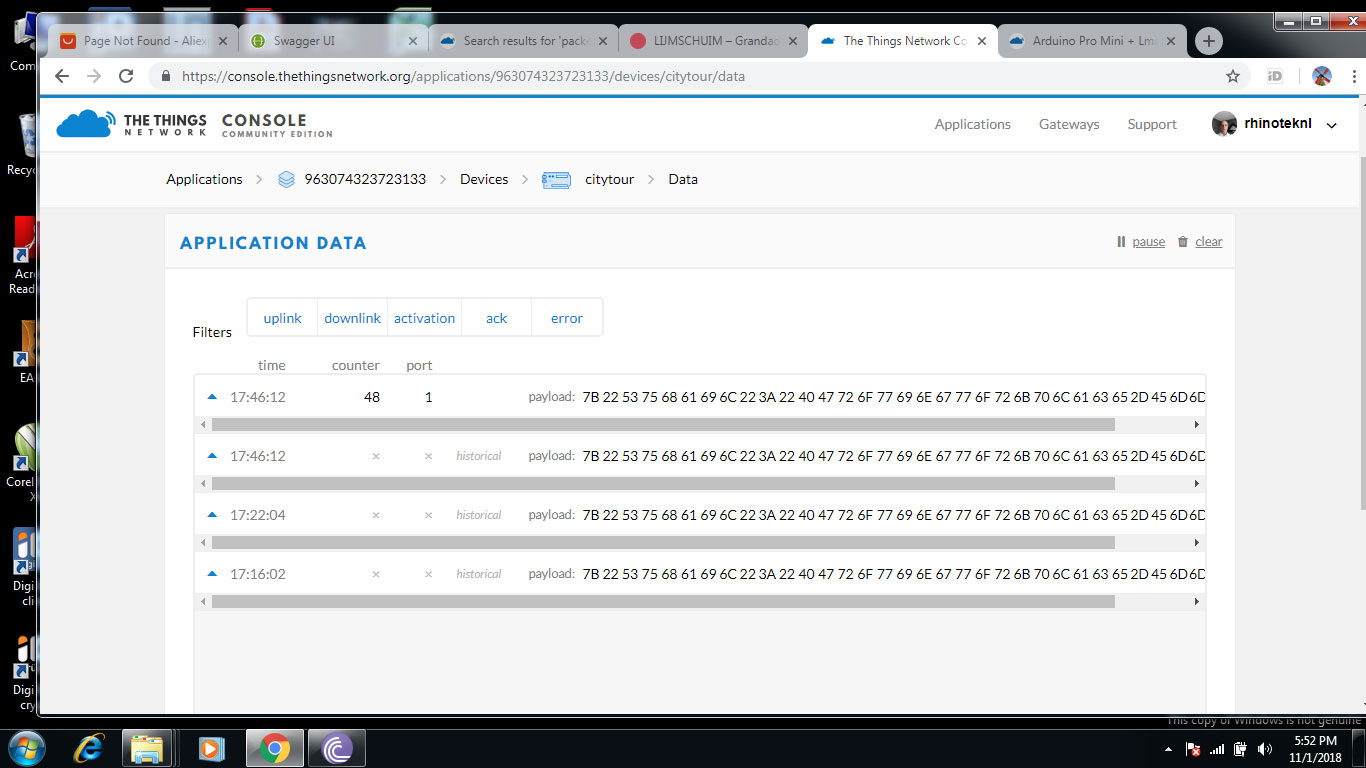

can you show some packets received by your gateway / application ?
i have interval of 6m
I mean with the metadata visible (click on one of the blue arrows pointing upwards)

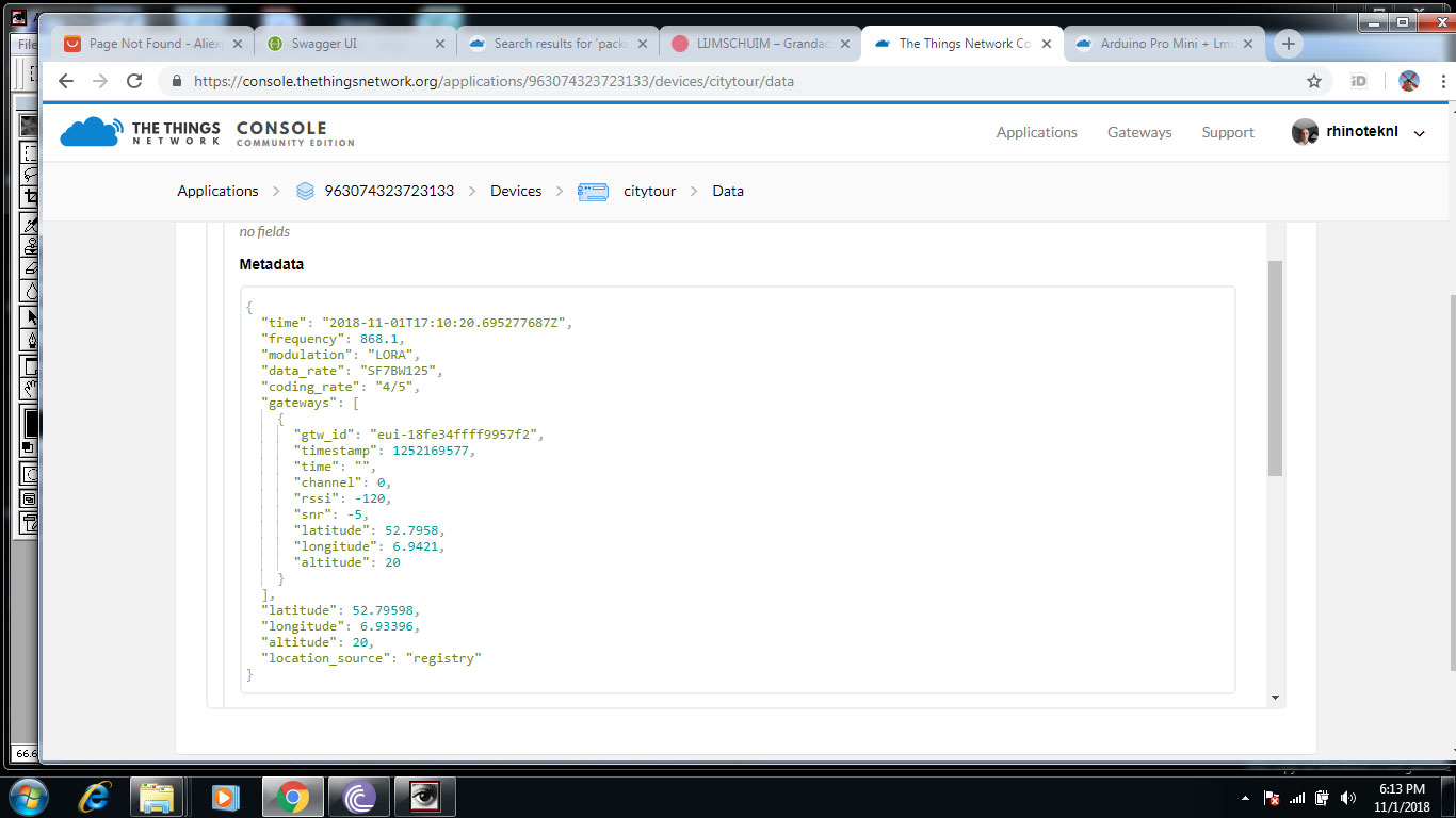

this is metadata
OK so you are transmitting with SF7 and that gateway is receiving your weak signal of RSSi -120 / SNR -5.
Then it’s indeed possible, that when you are moving the node (for example to the other side of a room) the signal gets to weak for the gateway.
