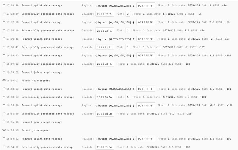

Hi guys,
I’ve finally made the LMIC (V.4.4.1) library work on my arduino pro mini 3.3V (made some posts 1 month ago : SX127X not accepted in TTN for the first 10 minutes - #9 by shutdownsystem), Mainly with the help of this project : GitHub - JackGruber/Arduino-Pro-Mini-LoRa-Sensor-Node: Arduino Pro Mini TTN LoRaWAN Node with RFM95 module battery-powered.
This project needed VScode and plateform.io, and as I want to use it for beginners, I did the migration to Arduino IDE, using this library as a bridge.
It works pretty good, and when I insert the Low Power part (using avr/sleep.h), I go to 0.1mA which is good enough for me. But when I insert it, it also looks like my Arduino restart from the beginning (doing the setup, etc). Here is an exemple of the TTN Console, my serial monitor and my code.
Do I miss something ? Why it’s joining everytime before sending the message ? (And also why it doesn’t care of the sleep interval of 2min ?)
(note that with the github project above, there is no problem…)
Thank you,
LMIC: 4.1.1.0
LoRaWAN_Setup ...
Packet queued
Starting
190425: EV_JOINING
568163: EV_TXSTART
889298: EV_JOINED
netid: 19
devaddr: 260B7FE3
artKey: 976D5CFEDD09EBC2E16B2CF6298B137
nwkKey: 3B8A8A75756D7854C303B75DCB5A2B8
890671: EV_TXSTART
1272380: EV_TXCOMPLETE
PowerDown...

745527: EV_JOIN_TXCOMPLETE: no JoinAccept

Yeah, I was going to mention that.
Does this mean it now works, or were you adding it because it had dropped off the bottom of the post?
Thank you @descartes :slight_smile:
It first looked like it was working, but actually I had one more unexpected joining.
I’ll let it run for the night and come back here tomorrow if there is a problem :wink:
There is already a HUGE problem - you are breaching the FUP with 120s uploads …
