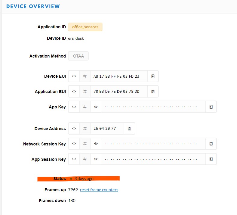

Since the 1st December no payload packets are passing through from any of our test sensors - Sensors/Gateway all appear to be working as expected however the device status only shows the last connection as 3 days ago.
My nodes are able to join OK and uplink packets are appearing in the gateway console but packets are not appearing in the device console for any of my 2 nodes, nor is data being forwarded to my platform. This started happening about Dec 1. The the frame counters seem to be correct on the gateway console but show ‘0’ on the device console for up and down.

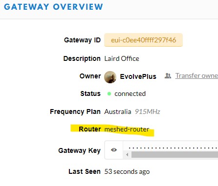

The affected device DevEUI is: A81758FFFE03FD23 and the Gateway EUI is eui-c0ee40ffff297f46. The gateway is configured for meshed-router

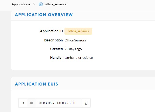

@EvolvePlus …and the app on meshed-handler?
Oh sorry Andrew - I forgot to mention: Handler = ttn-handler-asia-se
