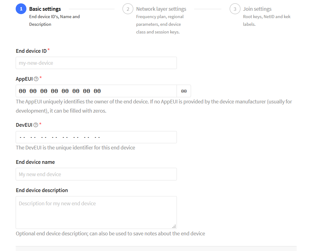

Hi Guys,
I’ve noticed that there’s no option for auto generate AppEUI and DevEUI in thethingsstack v3 anymore (as compared to TTN):
To be honest, I don’t have so much glue so I needed to google a bit to find related threads:
Custom RF95 hope solution: HopeRF RFM95 and arduino a low cost LoRaWan solution - disk91.com - the IoT blogdisk91.com – the IoT blog
What is the recommended procedure for adding a custom-built LoRa device using OTAA to v3?
Thank you a lot!
