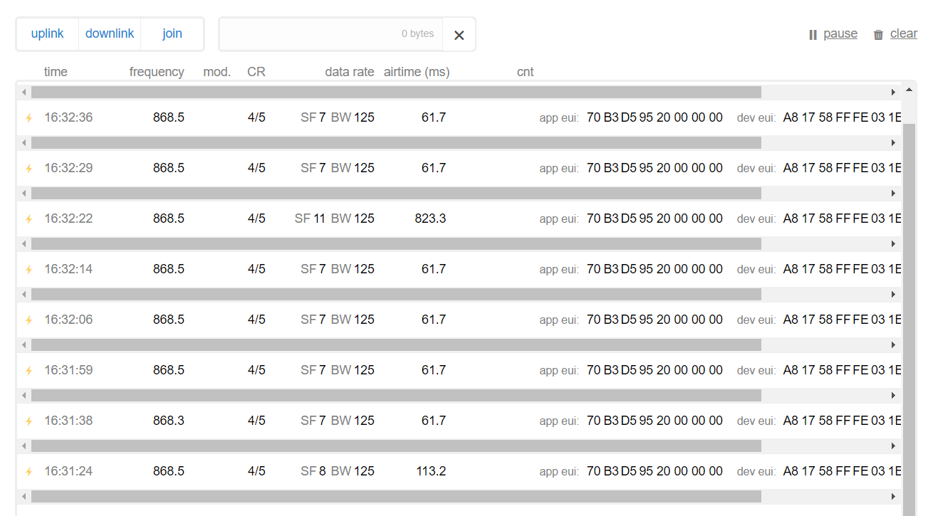

This is what can be seen on the traffic, there is no scheduled reply apparently. What is weird is why would you send a Join command every 7 sec from the node side?

Applications in LoRaWAN and The Things Network have a 64 bit unique identifier (AppEUI). When you create an application, The Things Network’s account server allocates an AppEUI from the address block of The Things Network Foundation. This means that every application has at least an AppEUI that starts with 70B3D57ED. If you have your own AppEUIs, you can also add those to your application.
So, 70B3D59520000000 is not generated by TTN. It might still be registered with TTN of course.
That not so weird (though: bad). A Join Accept in RX1 will be transmitted 5 seconds after the Join Request, and in RX2 after 6 seconds. So, after 6 seconds the node knows if it has received a Join Accept or not.

Just being silly, but I looked up the AppEUI and it appears to belong to a company named “Requea” in Lyon, France. Perhaps this info can make spotting the node a bit easier…

Hey Roseen where did you find the info concerning the AppEUI vs the name of this company Requea?? I want to contact them, I am curious about where their node is located as lyon is somehow quite far (<>60-70 km straight line)… and I want to shut down their join request to be frank! (I know sounds like I am a weirdo :wink: ) I have <>60-80k/month messages passing through my gateway, I would prefer the Bandwith allocated for useful stuffs.
Oh, that won’t help! They are just the manufacturer. It would be like calling Volvo when you see a speeding car.

This guy (apparently a company) is sending over a join request every 7 sec, 62ms airtime, so roughly 1% duty used for nothing (& this node doesnt seem moving, prob waiting for a private gateway passing by…doesnt make sense) . I understand that may sound like a drop of water but still this guy pollutes the surrounding leading in interfering with other potential users (I got nearly 100K messages/month in this area). What we do is clearly for the community but on the other hand I can see it has brought businesses : they dont share their network, they prob dont spend much time on a proper setup & they just ‘throw’ devices in the field. Although uncontrollable, ideally it shall be avoided.
