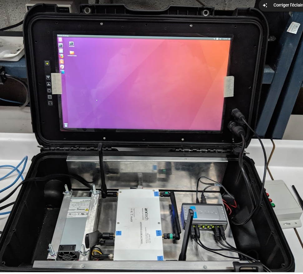

for example as an added value of someone looking for a chip/dev module, I’ve built a dev kit server/gateway to test lorawan in a mobile fashion, it get’s 4G-verizon, rogers, bell, tellus ready(PTCRB certified)/WiFi/LoraWan SX1301, 4x Intel LAN, IP67 compliant(once closed, ha!), on wheels. carry-on size… no Rpi here!!
a bit off topic… but what screen is that ( I guess a hdmi/touch 10.1 inch) cause I want to build a suitcase like that :wink:

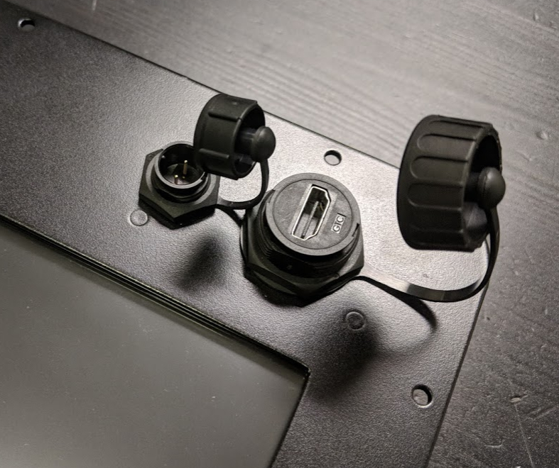

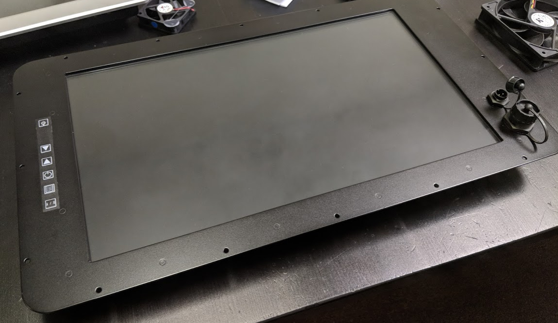

it’s an industrial custom made panel frame, 18,5’’ Full HD 1920x1080, wide view angle 350nits (1500nits available ) HDMI, VGA, DVI, (( only HDMI is front accessible in this specific case )) and a wide power input 9~36volts DC sealed connector. this one has no touch, it has a anti reflect 4mm tempered glass… really sturdy. but I’m able to make it with either resistive or capacitive touch via USB/RS232 if needed no problem.
the 18,5’’ was the biggest size possible in the carry on model. I also do smaller sizes with less options… all configurable on needs, and the beauty of it, … I can make one unit production. no need for a thousand unit. :slight_smile:

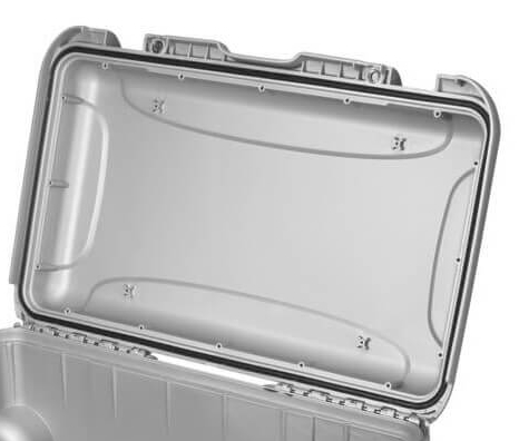

I’m into industrial embedded PC, for food industry and HMI mostly… but I always wanted to make suitcase like this myself… so here is my first one ! many details will be adjusted in the next version but I think it’s a good start. Been selling a lot of custom made stainless panel so it’s not very hard to just make a custom front panel that matches the selected luggage. I have a model for each Nanuk that has mounting holes in the top cover.
we do drawing to match perfectly the mounting screws and round corners of the case…
here is a close up picture;
looks great !
should have buy that case yesterday grrrrrrrr
https://www.aliexpress.com/store/product/355-272-106mm-Hot-sell-IP67-Waterproof-Hard-plastic-Protective-military-equipment-case-Custom-Hard-Mechanic/2007003_32833318826.html
http://www.nanukcase.eu/
Thanks ! :slight_smile:
carefull here… looks like the aliexpress model will not have mounting hole on top cover…
tnx (I have a gluegun :wink:)
