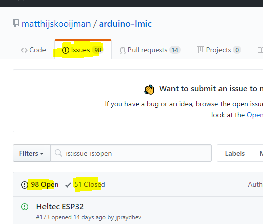

Secondly I am building my node with an Arduino Pro mini and another RFM95. This I also can not get working. In fact I can’t even find code that compiles for it. I want to use this library:https://github.com/matthijskooijman/arduino-lmic
I basically need just a sketch that sends “Hello” every few seconds to check if the node works. But when I try to compile I get the following error messages:
/tmp/ccCR9spz.ltrans0.ltrans.o: In function calcBcnRxWindowFromMillis': /home/user/Arduino4/libraries/arduino-lmic-master/src/lmic/lmic.c:412: undefined reference totable_get_ostime’
I hope someone here can help me. This took me multiple days so far and I still don’t know what my problem is.
