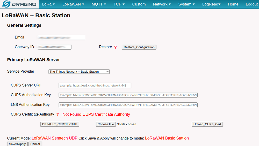

I’m not sure if the instructions online are just dated, but the TTI instructions for the LPS8N seem to only cover setup using the Semtech UDP mechanism. Is that intentional? Here’s a look at the Basic Station setup page for the LPS8N, where would you get the info needed to fill in these fields?

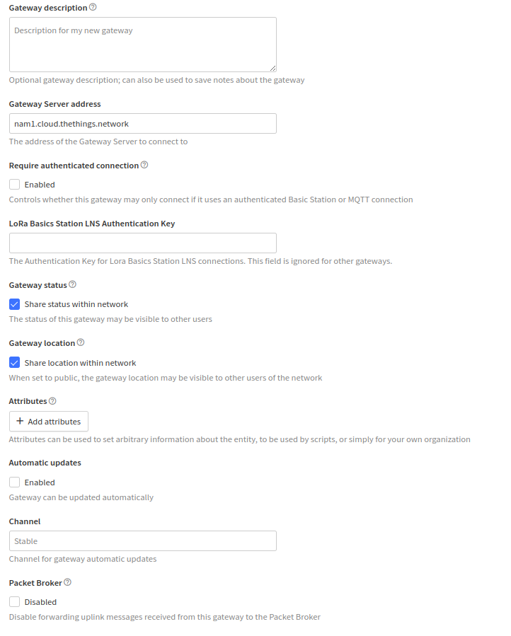

My guess is on the TTN console page for the registered Gateway. Can you change this on the TTN console after the fact, or do you need delete and re-register the Gateway to do this? Here’s what I see on the Gateway settings page on TTN Console:

Basic Station uses secured IP connection, uses routable traffic, allows retries (but may be of limited value in high latency environments as retry may fall outside acceptance window and fail anyhow). Needs a secure key hence the Authentication Key option above. As such harder to spoof implementation.

If you do want to change, remember the golden rule of searching the forum for the rather overused but under searched phrase “EUI is not ID”
